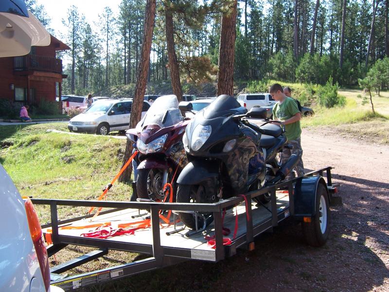

Tie down the front to the lower tripple clamp. Make sure to stay outside of the brake lines on the right. Depending where the tie downs are on the trailer, you may need to tie the straps to the rails or each other to keep the straps from rubbing against the fairings or fender. This picture isn't the greatest, but you should get the idea.

where ever the strap touches the fairing, just tie a rag around the strap.

There is a post on here somewhere that deals with tying down a bike for transport. I haul in my truck and secure both front and rear in accordance with the 45 degree rule. Once I cinch the bike down it will not move, up down, forward or backwards. Getting ready to load up and head for Monterey and will post up some pictures. Trailering should work the same way, you want to secure it with rachets on the front and cam type on the rear. You want to ratchet it down down tight so that when hauling there is no play in the suspension when you hit bumps. The 45 degree rule takes care of any sudden stops or acceleration away from a stop. I secure my front straps to the fork tubes just below the triple clamp and they clear both the brake lines, fairing and fender. Good luck with your trailering.
