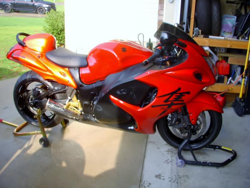

If anyone is using a PitBull front stand like this could you tell me if there is any thing that I need to be cautious about or need to do before lifting the bike with it. I am going to be borrowing one from a friend of mine to do the forks on the Busa next week and just need to know if there is anything I need to watch out for or any places I need to be careful when lifting so I dont break any plastic. Thanks Shane

Just be careful to put something over the fender so you don't scratch it. Also Busa takes a #6 pin.

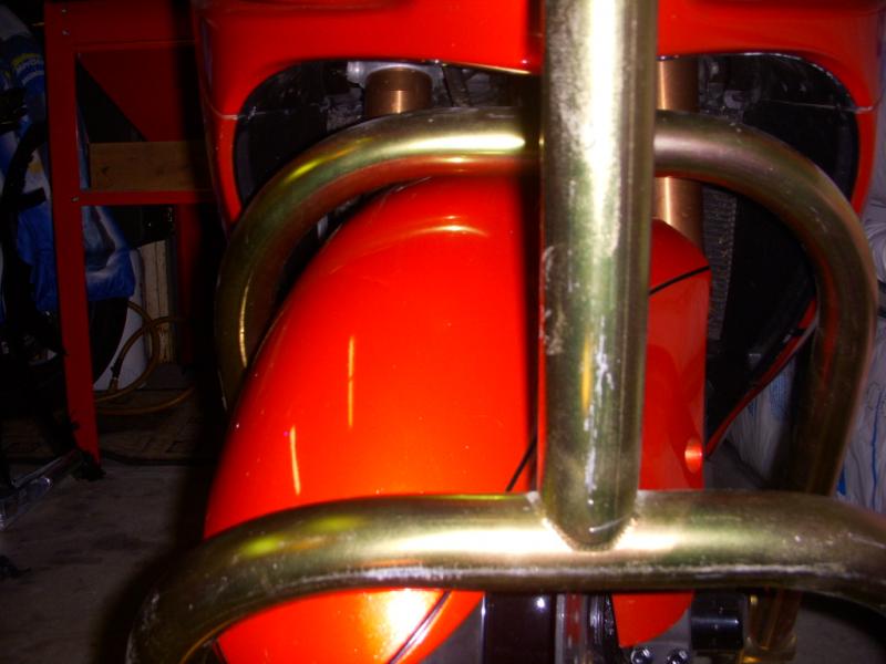

Also besides putting something on fender just for safety sake. I took a couple pics to show you how you need to turn front wheel to gain some clearance to get the stand up in there. I didn't put any rag on fender so you could see just how tight it is once you get it in there. It is a nice tight fit any normal red blooded male would normally be looking for, except this one is while trying to put this Pitbull front stand under your busa. :laugh: Slightly turn the wheel and once you get the stand up in there you gotta finesse it a little bit to get the pin seated firmly, and after that any pressure lifts it easily up some and no clearance problems at all after that. And just use same finesse when removing stand as it is just as snug going in as coming out.
Once you get the stand there as sorta in place it will all make a lot more sense.

Actually just clicked you were doing forks, so if you just remove fender first you shouldn't have any problem. If not for doing the forks and if you don't have or are looking for a f stand this one I recommend, easy up and very sturdy. Way better than trying to get the forks to balance on the other under fork style stands.
:thumbsup:
Awesome thank you sir for the pics, I already have the regular PB front stand, So just going to borrow this stand from a buddy so we can do the forks, Thanks for the info and the pics I appreciate it very much:thumbsup:

Mine works pretty easy, but to be safe I always put painters tape over the front fender and put my hand over the pin/(end stand section) before it goes in place, so it does not scratch up my radiator

I have this stand...it's brilliant! I have never had a problem scratching the fender, but I will warn you it's a bit fiddly getting the pin in the right position because of the tight fit and the angle./ After the first time it's a piece of cake. Make sure the rear stand is on first of course. You'll be surprised how rock steady the bike will be and how easy the front is raised.
