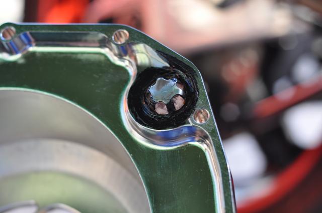

pan
I removed it like this

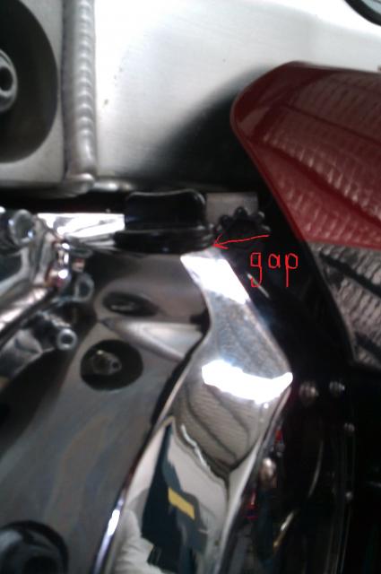

Mine looks like this, but I've had problems with it
The build quality of the Chinese cover is crappy. The cap doesn't fit on straight, hence there's a slow leak
Hope yours isn't the same one!
The stuff I used to stick the window thingie in place is called Sikaflex

Sucks about the leak Pan. Maybe a thicker o-ring? Tiny bit of silicone after each oil change? Wrap the threads in plumbers tape?
What brand of cover? So we can choose to stay away from if desired.
Chinese krap:crowbar:

pan
RSD.
Thicker o-ring didn't work. It just got pinched and forced out one end. Didn't try plumber's tape.
Heat proof silicone did the trick!
The cover was about $80 delivered off eBay.
