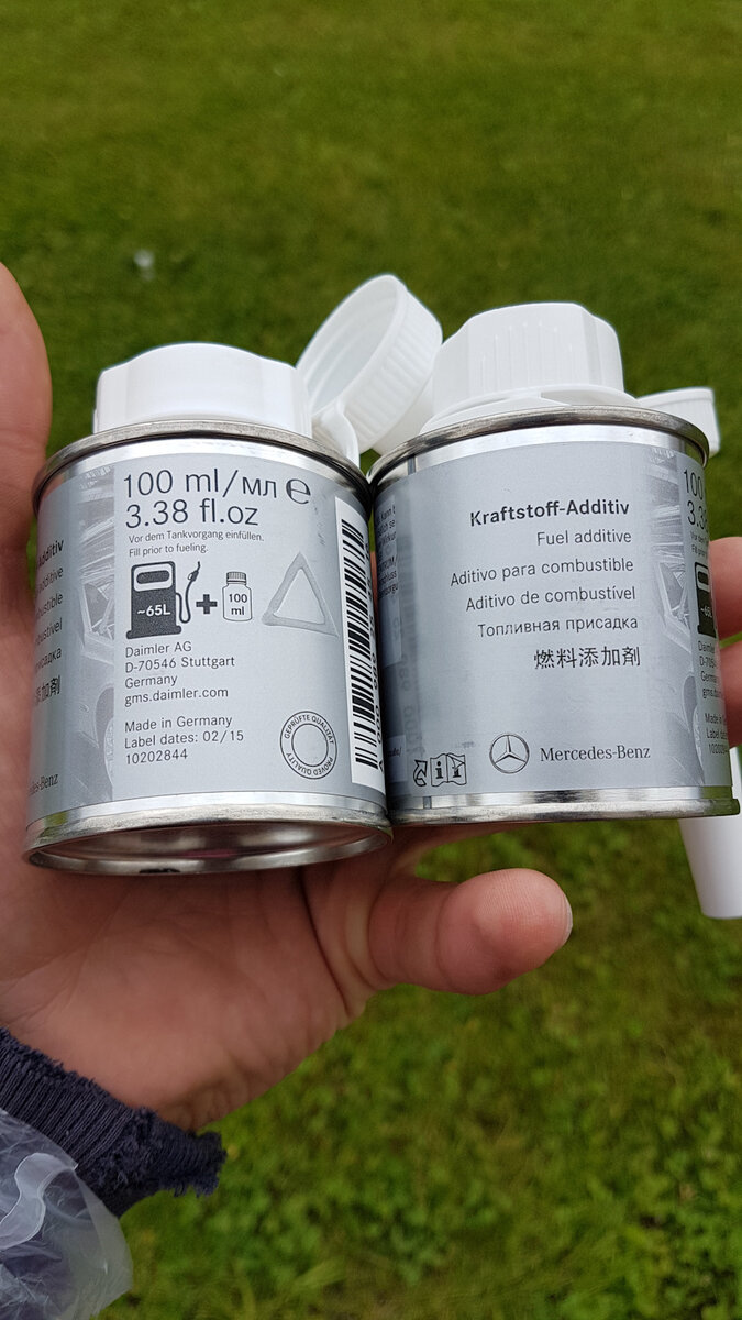

:welcome: to the show dude. Can't help you with a 100% correct answer on yer question,but I would suggest you don't stop at fluids.7 year old tires need a look see,so do fuel lines,battery,fork seals,perhaps a fuel treatment to make sure everything is clean and flowing good,injectors,etc.Especially seeing yer mystery substance there.
Lots to choose from on the market,SeaFoam etc...I swear by this stuff,yer local German car dealership will hopefully have it.

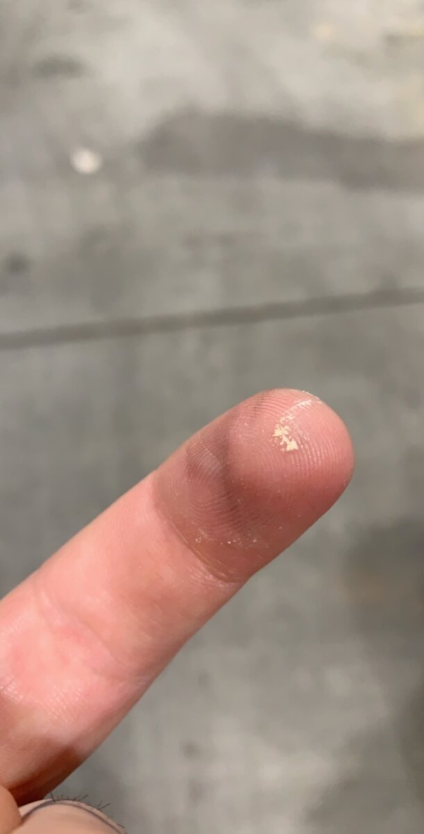

I do not know that that powder is. Is it slick? It is not the common gray graphite but I wonder if a powdered lubricant was used to free up a sticky gas lid. People have a bad habit of using powders to lubricate mechanisms that truly should be cleaned and definitely not gunked up with solid lubricants.
33,105
56,373
It looks like dried fuel through condensation...if the bike was stored in an environment where it got warm then cold over time, the fuel will condensate with water vapor then dry like that.
Check the inside of the tank, if it's clean with no rust-then no problem.

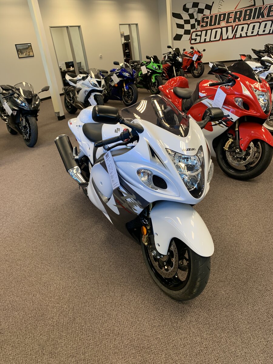

I’m away from home. I’ll have to take more but I have a few. The color is white with blue in it. And the stuff wasn’t really slick it was the consistency of girls concealer make up I guess lol It smelled like a weird chemical smell. The tank doesn’t look rusty at all.

Great looking bike-one of my favorite colors.
I wouldn't be worried about that residue, it looks like dried fuel to me..
If the inside of the tank looks good, you are golden...
I just messaged the guy and he said there was seafoam fuel stabilizer in it.

Cool. GTG.
