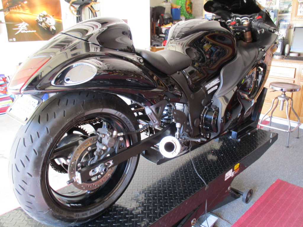

Alright, this stumped me since I got the bike in December 2023. It wont rev past 7k rpm at 5th gear on 200kmph.
I did air filter, fuel pump replacement and fuel filter, fuel regulator, cleaned injectors, new spark plugs, and its still wont go further than 200kmph.
I saw a comment about gear position sensor hitting a certain ohm so that the bike wont have a “speed limiter”. (Not sure why is that). I have the vid above confirming that my gear position is busted. Im on 5th and its going 6-5-6-5 then blank. Im trying to get my hands on the position sensor, but your inputs are much apreciated!
