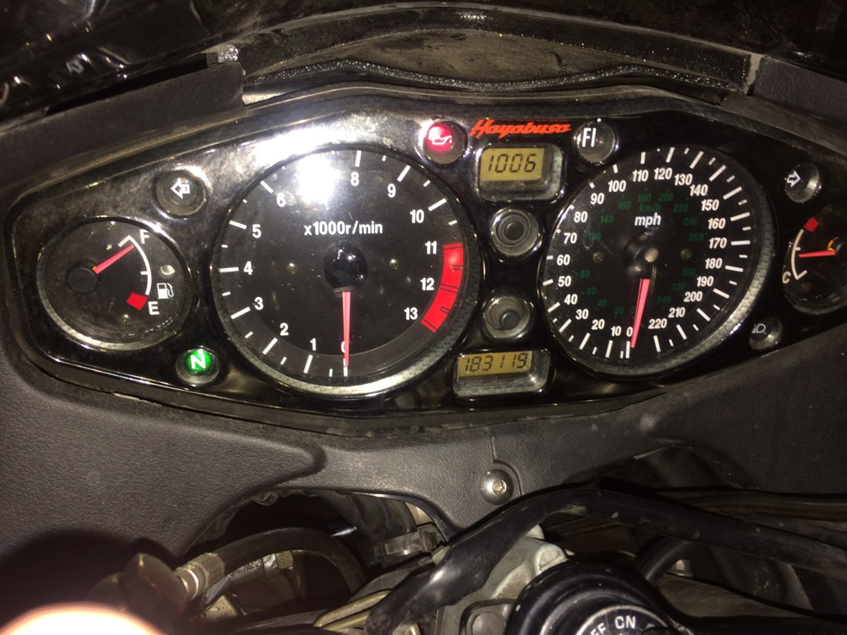

Hello Everyone, Thought I'd post a short note and a couple of pics of my 1999 work horse Busa. She's no longer the bell of the ball on the outside and no longer a teenager but at 183k miles I understand this machine and feel comfortable and confident riding her. We've had a few rainy winter storms here in California this season which turned up a pesky ignition problem. Hairline cracks in the coil sticks - very intermittent - ie. heavy rain and no side fairings. Cured with some new coils - the original stock coils have served me well. Hope you enjoy the pics. I'd say she's got another decade!

WOW, that is a lot of mileage.
Besides the coil sticks, please share with us any bigger items you had to take care of to keep her running.
33,023
56,197
That's a testament to how tough these bikes are.
Did you have any issues other than the coil sticks? Any big maintenance issue?

Yeah, you guys have a nose for news... I'll tell you what never ever has issues - the engine - I measure value clearance every 40k miles - always within. Compression - always within. What I do do to keep the old girl happy:
1) oil - FullSyn every 3k miles
2) K&N air cleaner - rinse with simple green every 20k miles (should do more BayArea = dusty)
3) Carb sync every 20k miles
4) Chain clean and oil/wax every - alot - a least once a month (and tire pressure)
5) the '99 has the external fuel pump, been in there 3 times, 2 new pumps, always all new o-rings including and especially the fuel rail. Fuel delivery on these things is everything.
6) Starter motor go the flat spot at 160k miles - changed for one from some dudes in Detroit
7) Welds on the stock 4 into 2 exhaust (Yosh slipons - had to put a heli coil into one side)
8) Steel brake/clutch lines.
9) New (stock) clutch springs only, at 140k miles. Plates were good - just started slipping in 5th under hard acceleration - weak springs.
10) One contiguous wire harness from generator to rectifier. All those connectors melt. Went to 12 gauge stranded double insulated wire. The rectifier and generator were 100% good - as I suspect are most that end up getting replaced (IMHO).
11) Thick ground wire from rectifier to battery (6 or 4 guage)
12) Fork seals and fresh oil at 150k miles - what a difference over 120mph in settling the slightest resonance.
Those are the ones that come to mind guys, thanks for asking. I've only had 3 street bikes in my life (still have 2 of 'em):
1) 1973 Suzuki GT185
2) 1976 Suzuki GT550
3) 1999 Suzuki Hayabusa
I also have a KLR650 stashed in Asia and I'm going to bring her home in the Siberian springtime!
