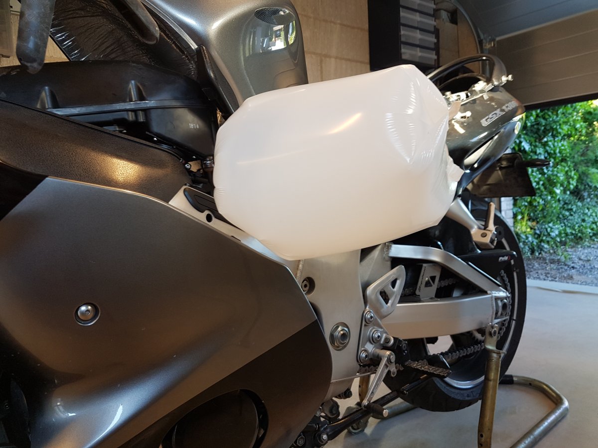

I dont know if its of any use, but I put a bag on the crankcase breather hose, and in 90sec it filled the bag. (blowby?!)

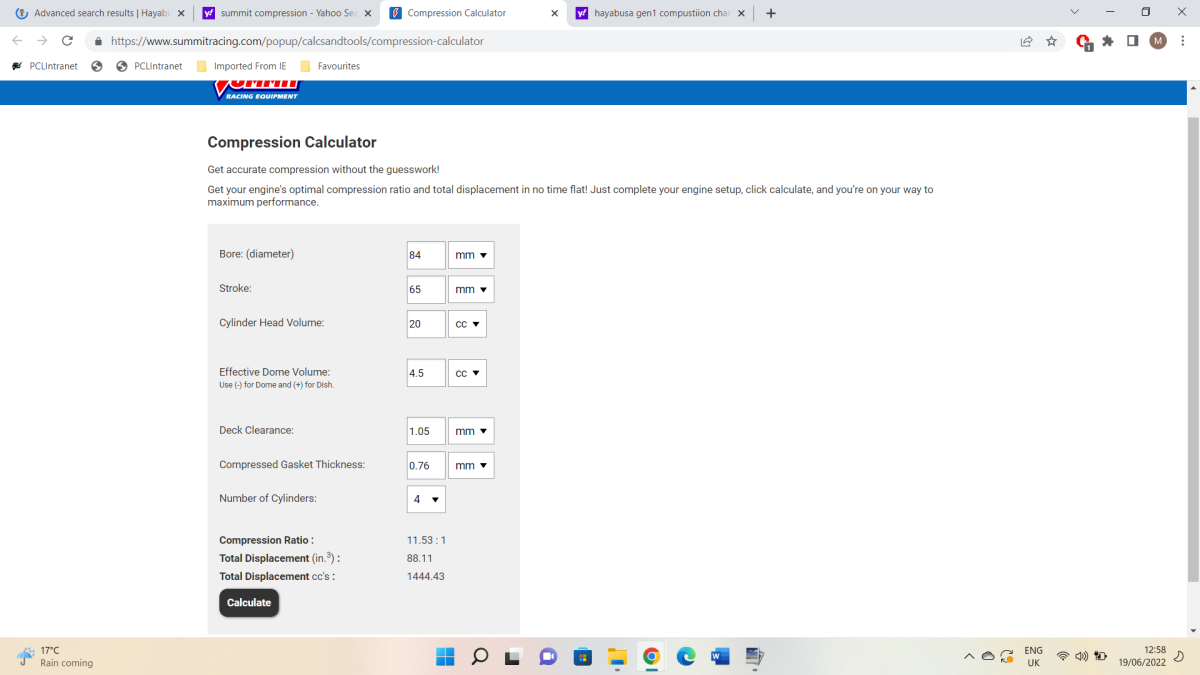

how do you know you have 12.88:1
did you check volumes of combustion head and piston etc ?
deck height calcs
just saying ?
deck height calcs
just saying ?
My conclusion is piston rings did not seat, due to improper break-in and cylinder got glazed. Leak test showed too much air escaped through piston rings and out of crankcase breather hose. I compared leak to my stock spare gen1 hayabusa motor. My cam choise is selected towards low/mid rpm power. Bigger lift/duration cams and thereby bigger overlap will trade low end for top end power.

why did you not add gasket thickness 0.76 mm i believe this will lower your compression to 11.5 or something - you say you measured everything if you have a Gen1 head normally they are 18cc, but presumably you measured using a burette and flat plastic plate??

the rings were broken in on the dyno 6 hours running time

Due to headwork, cc volume has gone up. Why would I go lower in compression than i stock gen2, which run fine on 95 ron pump gas?! Pistons are adverticed as 12.8:1 for a 1397cc motor and have APEs blessing to run on pump gas all day long..
i am not saying you should run lower, i just wondered why you did not add the thickness of the head gasket
