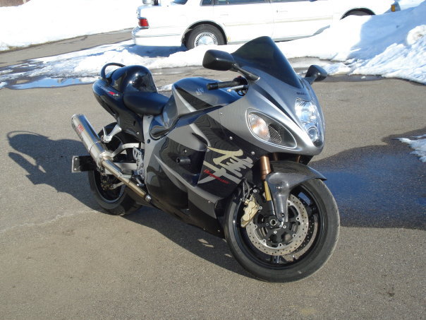

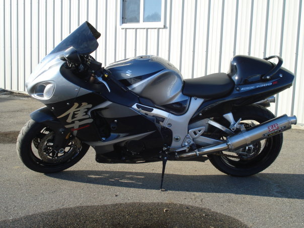

Here are some photos of my 2005 Hayabusa. With the stage one turbo kit installed, would the only cosmetic thing that would give away the "sleeper" look the dump pipes and turbo air filter sticking out from the bottom left fairing?

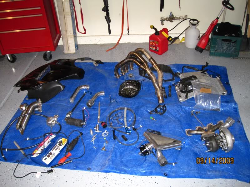

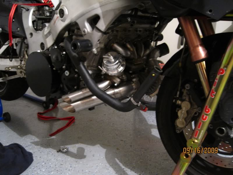

RCC stage 1 kit has small air filter included that fits inside the body work. Save yourself the headache on the pipe and just include the RCC pipe in smithabusas pic above when you order the kit (upgrade), compared to trying to fab up a dual pipe to connect to the turbo header or having a dump pipe.
Yes, its a bolt on kit you can do in your garage. My engine had 11k trackday, dragstrip, daily driver, touring bike miles, etc on it and I just bolted on the kit, trailered it to the dyno shop had had fun on 6 psi. Only six psi due to 91 octane and desert heat in the Summer time, and 11k miles on motor.
You don't "need" spacer, studs, BOV or an intercooler, yes they help but then you may be talking about more work than just bolt on with simple tools. RCC sells the kit as a bolt on so just bolt it on after spending some time talking to RCC.
