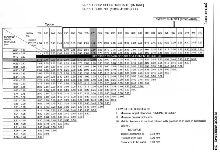

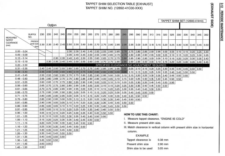

big...it shouldn't be too daunting for the novice home mech to perform this task...per the shop manual page 2-8 in the "Periodic Maint." section outlines the procedure quite nicely...with the most scarey part being "Cam Removal" (should you need to swap out some shims) which isn't really all that scary at all and is covered in section 3-28...15 minutes of reading and your average DIY type will feel nearly confident and competent...and after post an in depth pictorial tutoring on the subject?...it should be "Just Follow Thew Step-By-Step Instruction/Pictures" childs play.
and outside of a good ratchet set?...the only non-typical special tools we may need will be a torque wrench and a magnet.

didn't read all the gobbly gook.... but the first to things to try are:
1 - measure all the tolerances and record the shim # in a log. then see which of those shims can be relocated to another valve. This can decrease the number of needed shims greatly.
2 - Find a smaller shop in your area (dealers may help depending on your relationship with them) .... and do an "exchange" with them for the right shim you need.
I have found this to be a successful plan of attack for many bikes in the past.

I agree, we should stick with OEM or a known quality shim. The exchange coming back should be the same. I think if we covered the same sizes as the Service manual quotes it should be sufficient. The 9.5mm fits a bunch of applications so it does not surprise me that Sudco offers 40 sizes.
I’m betting if someone needs a 1.35 mm shim in a busa, something is not right. Valve/seat cut wrong, aftermarket cam with a screwed up base circle, something, but they have much bigger problems to worry about than the shim bank not having a 1.35 shim.
What is the 035-006 kit available for? Maybe we could get a board sponsor to “sponsorâ€￾ this by selling the kit and/or OEM shims to us at cost. I know my Sudco account is long gone.
I’ll buy in on the deal, but I think getting shims outside of 2.3-3.5 range is wasted money that could be spent having a deeper coverage.
