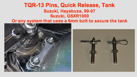

Tiger Racing (site sponsor) makes a quick release pin for the tank. $26.95.
Tiger Racing Hayabusa Tank Pins
