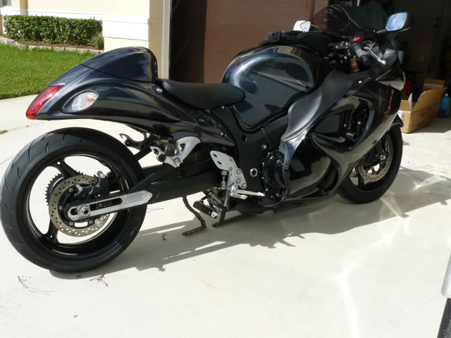

Never had a problem with mine!!! it's been on there for three years now. Trust me its had plenty of acceleration:laugh:
Just did mine, Give me some time and I will let you know :laugh: However after talking with the group here Im feeling pretty confident Im ok.

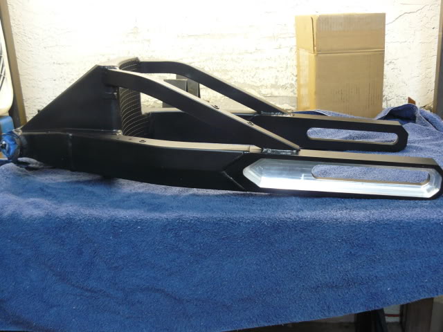

Extentions are fine, cheep ones will flex. I ran a set of bolt-ins that i got from Brock and they where nice. My buddy got a set of Flee bay's and they flexed and eventually snapped (not the first time ive seen this on 250+hp bikes with bolt ins)
Best way to do it is get a set of weldins, and change your upper support to weld onto the extention and not on the swingarm, i would go about 1/2 back onto the extention.
Bolt in advantage....you can take them out
Weld in Advantage...No problems if installed correctly
