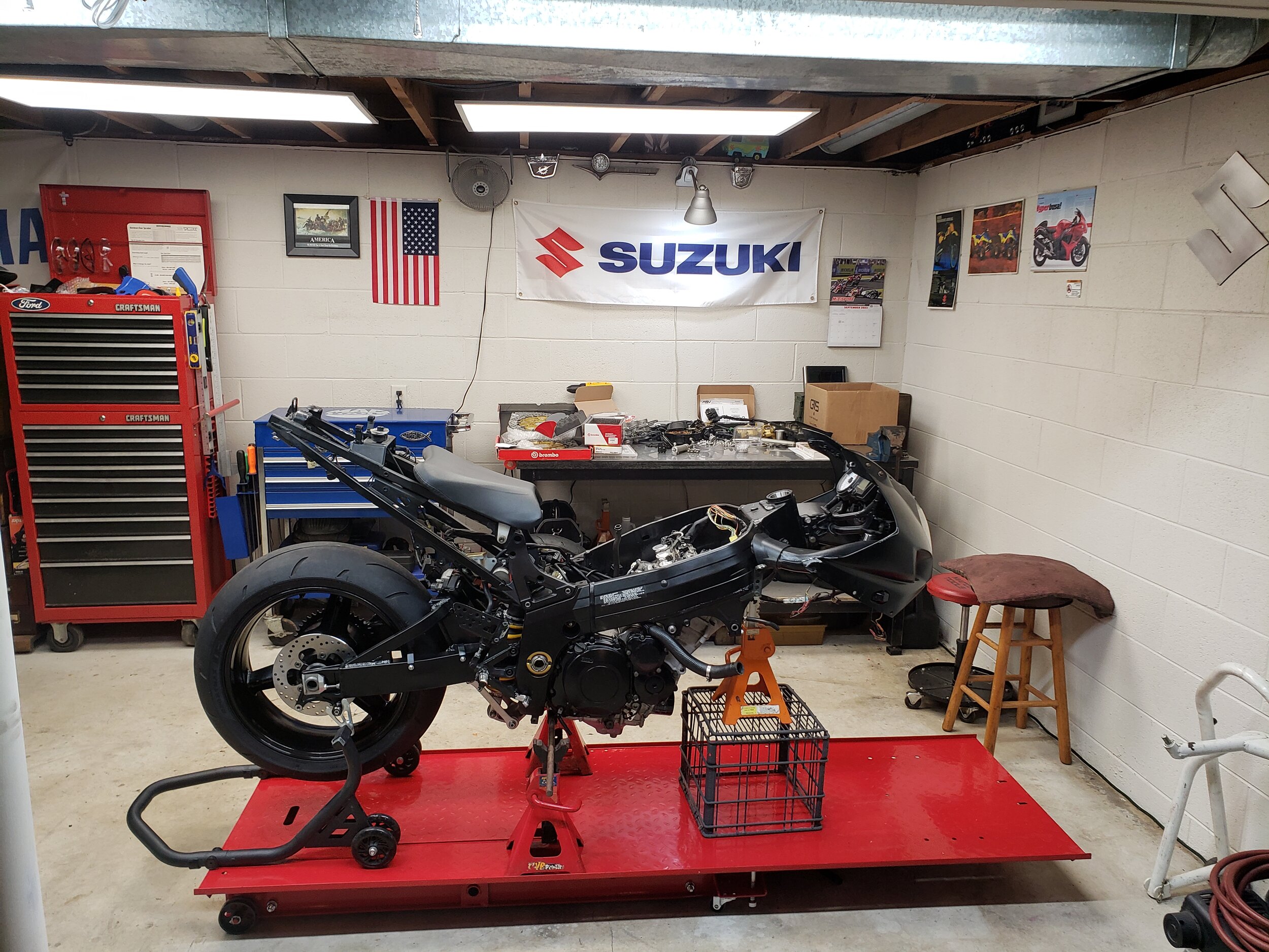

Can you get a steel bar about 3' long?
Run that under the header pipes where they exit the head, and set the bar ends down on 2 jackstands, I have done that before sucessfully.
I replaced the steering head bearings in my '03 Gsxr1k a few months ago(same as the Busa).
Whenever I do these bearings I end up doing them a different way.
This time, I had the front on a forklift stand, lifted under the lower triple clamp, pulled the fork tubes, then lowered the front of the bike on to a jackstand.
It may look a little sketchy, lol, but it was rock solid and too easy to do.
Hi. It looks rock steady to me too.
