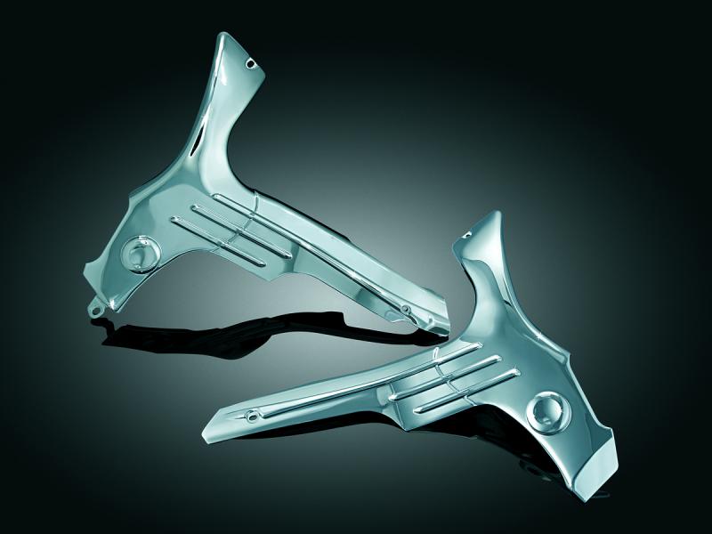

A great polish job looks incredible but it is a ton of work and it REALLY needs to be done right. Plus even after a good poilish job the upkeep can be tiring. We sell a set of chrome plated frame covers that bolts on in minutes and is a great solution. We sell a lot of these to people who already have polished frames that are tired of the upkeep. The covers we sell are injection molded plastic then real triple chrome plated. Not to be confused with the fake chrome vacum formed covers out on the market. Here is a link to our covers Real Chrome Plated Hayabusa Frame Covers 1999-2011

^^^^now those look nice, the polishing is a pita, had polished aluminum wheels on my truck, just keeping those looking nice was a chore.
