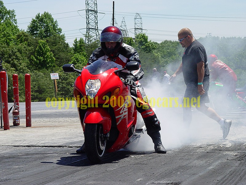

First weekend out on an all stock 04 limited edition, Schnitz front strap and lower links. Front tire pressure at 60lbs. Launch at 2500.
60'    1.788
330'   4.627
1/8    4.627
speed 109.70
1000   8.807
1/4     10.463
speed  136.08
250 lb suited up driver on Amoco premium
Looking forward to next weekend. I have drag raced a ZX6R for the last 3 years. What a difference, this bike is so smooth.

Nice pics and good times for your weight! Keep up the good work.
