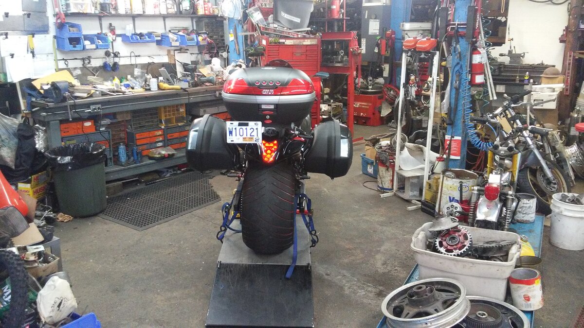

Yup...The STTB is ready to roll. Took a bit of doing,but totally worth it...yer gonna love it.
Here it is...The Super-Touring-Turbo-Busa AKA STTB...
Huh huh...whatcha think...
I know...it's it's...uhhmmm...
I get a feeling when I look at "The Black Bastid" now...is a kind of growing feeling,a sensation...yup,here it is
It's downright fugly.

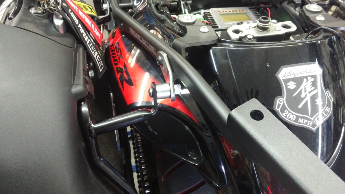

It took some work too. Guy who sold me the top case and mounts said I was "Good to go"...
It would all work together and be "easy-peasy" you know "Plug N' Play"

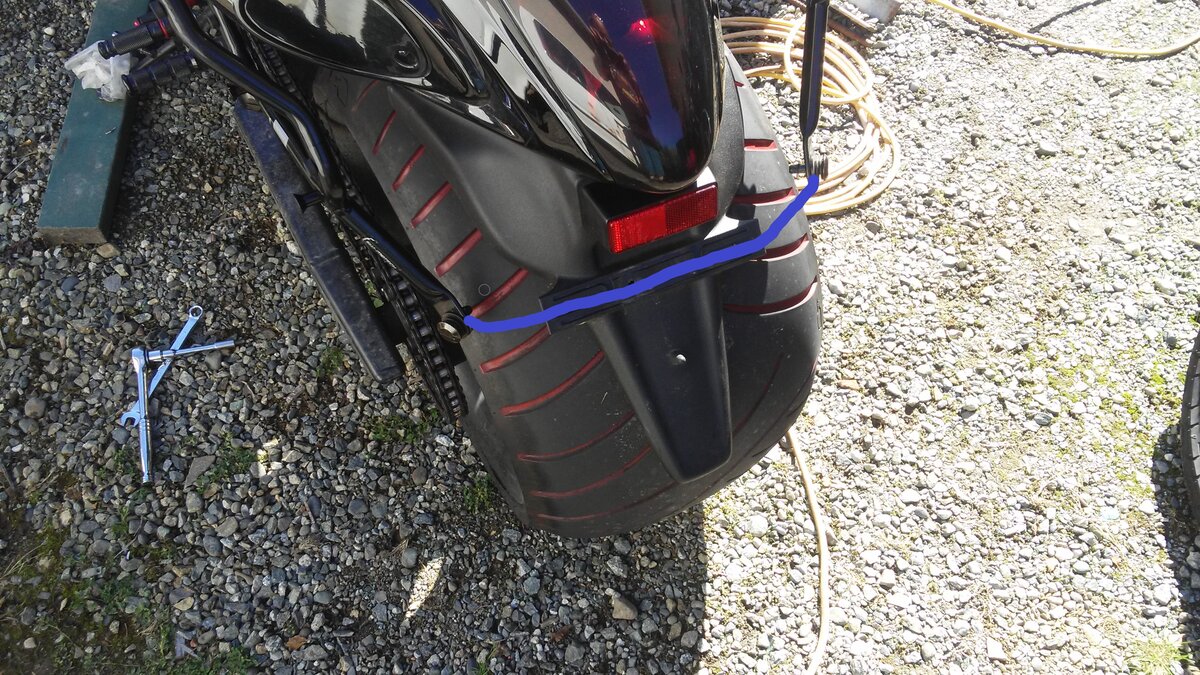

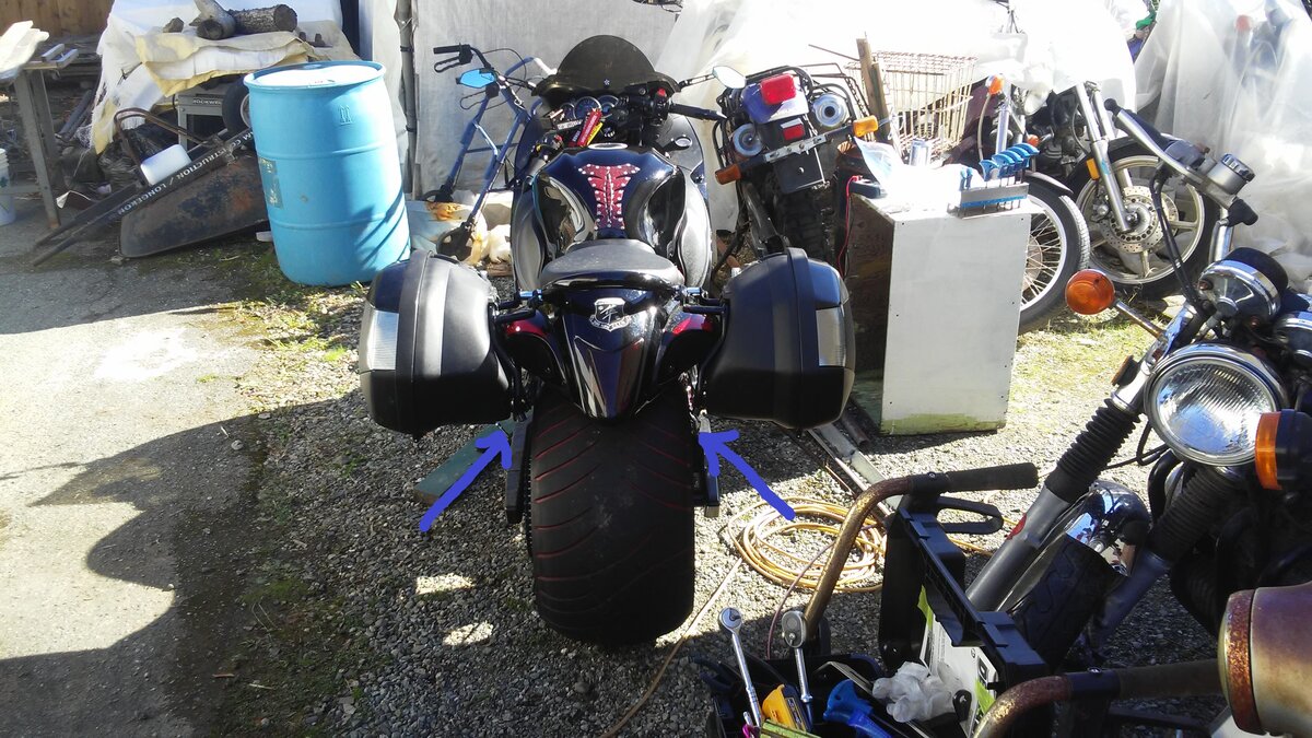

Well,fug you buddy,plug n play my azz. Several issues made me work a bit harder than I figured.
With the extended swingarm and fatty tire there was no way to fit the bottom support bracket from each point. The tire is to far back,and the bike sits to low for clearance.
I was going to re-install the OEM plate/tag/fender which is supposed to hold the rear mount bracket on a stock Busa. The tail is to low, and even with my rear air-ride suspension adjusted to max height,there was no room to fit the fender. Thanks again thou @Big E for mailing that to me. It was supposed to make that 4th attachment point a breeze. Nope.
Also my way cool expensive LED plate/tag mount from RoaringToyz had to go bye-bye. They hang off the un-used exhaust hanger and look really sharp,but that's where a hardbag has to sit now.
So that was couple weeks ago and I was fairly happy with the results. Had to scrap those things...but it looked tidy and not bad.Just enuff clearance...good 2 go.

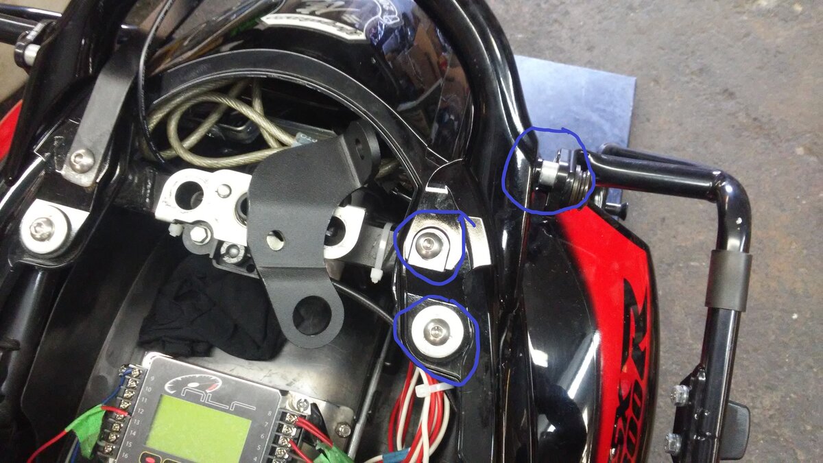

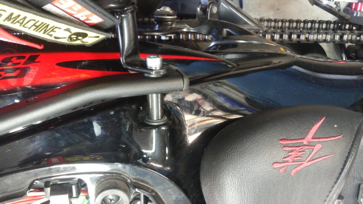

Mounting the hardware for the top case presented a few more challenges. Even thou "Mr.Plug n Play" said no worries,I had a feeling. The hardbags mount in 3 places now instead of 4. The 2 top mounts utilize the frankenstein bolt hole and the cargo net bolt hole on an OEM grab rail.
Well the new hardware for the top case requires removal of the grab rail,can't use it. Oh goodie. So I make the bag frame and the top case frame share the same front mounting point by over lapping them.Looks decent. The 2 are spaced out,away from the body work.
At the rear where the grab bar was attached there no way to over lap the 2 without welding something up possibly having to join the frames together which I dont want to do because I want the choice of bags or top case or both with 2 minute changes. So faced with this...
So I make a little bent,twisted bracket to mount both thru the same attachment point,get the clearance I need from the bodywork and have the bags line up perfectly with the lines of tail and bike.I come up with this...

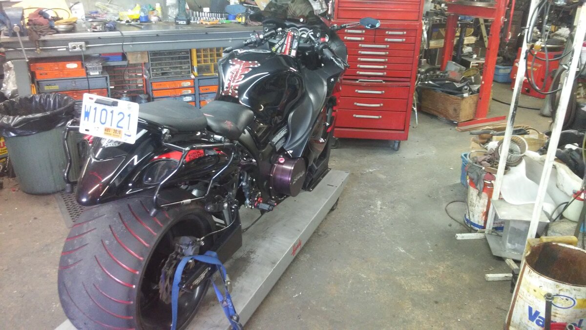

So being somewhat happy with all that I had to pick a spot to mount my plate and really no location worked. The tag looked ugly (nevermind,I know the whole thing looks fugly) no matter where I put it. It blocked the brake light or looked out of place,blocked access to the trunk key...:banghead: whatever. So I chose this TEMP spot for now. It partially blocks the left turn sig but I seldom use turn indicators anyway.
You'll have to excuse the mess,we are being kicked out of this space (Nov.30th) which we enjoyed for 33 years so things are a little chaotic. I took a couple hours today to de-tach from the situ and my friends grief and just play with my toy.

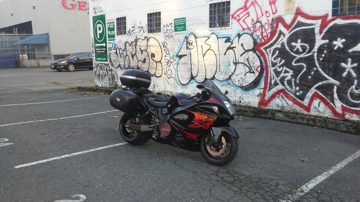

Oops sorry dudes,extra pics. That last one was taken a while back. I had just dropped of a new dollie and got caught in a monsoon. Took a pic because I thought "The Black Bastid" looked good after "being washed." :laugh: Who said I'm not up on cleaning and routine maintenance. :p
