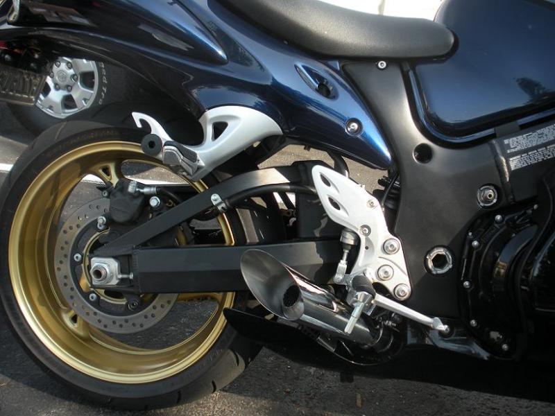

i finally got my new hb megaphones on today and wanted to post some pics up and see what yall thought....i posted up a thread before about getting the exhaust and got 50/50 reviews on the megaphones...there loud as heck and i did notice a difference in power but for the money i'm not complaining.....the wife doesn't have to worry about burning her leg now even though she is clumsy sometimes...... but i love her lol....does the pipe look positioned right??? thanks everyone for all the feed back:bowdown:

sport 71, i do have the same and i think you left the stock exhuast spacers on the header, you will need to pull them off to slide the HB's to the base of the of the header or risk lossing one on the fly. they surely look nice. :thumbsup::thumbsup:

The Megaphone definitely cleans up the appearance of the rear section. The sound is pretty obnoxious though. Might run rich now that you've lost all that back pressure. May want to consider having it tuned with a PC.
I have one on my 08. It cleans up the bike well as stated by others, but I've got to admit, the sound is deafening after a long ride.( to each his own) I have reinstalled my stock cans for now. I'm selling mine to get a full exhaust.

I love the way it looks, don't get me wrong, but I started getting a headache after an hour long ride. So I thought I'd rather enjoy the ride with my stock cannons for now.
