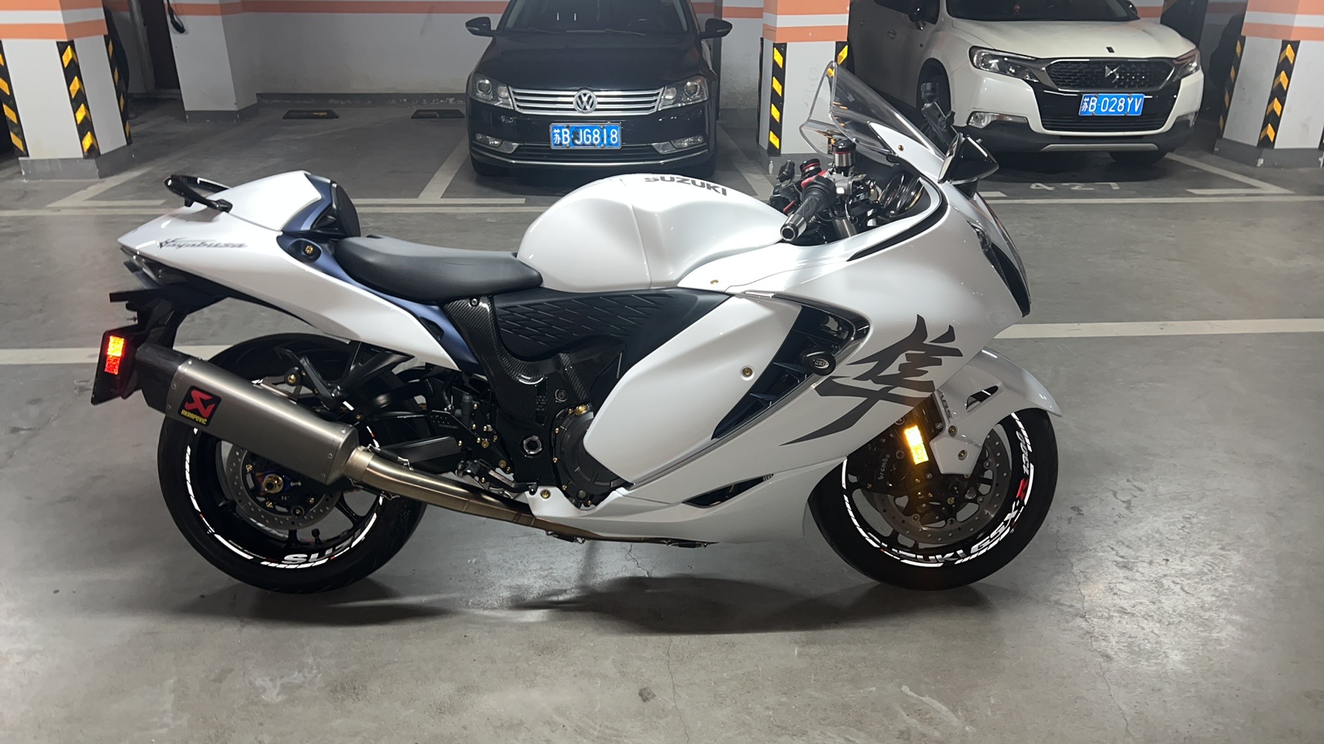

My desired looking is like this,
I mean exactly like this. I don’t do drag race , just for daily riding.

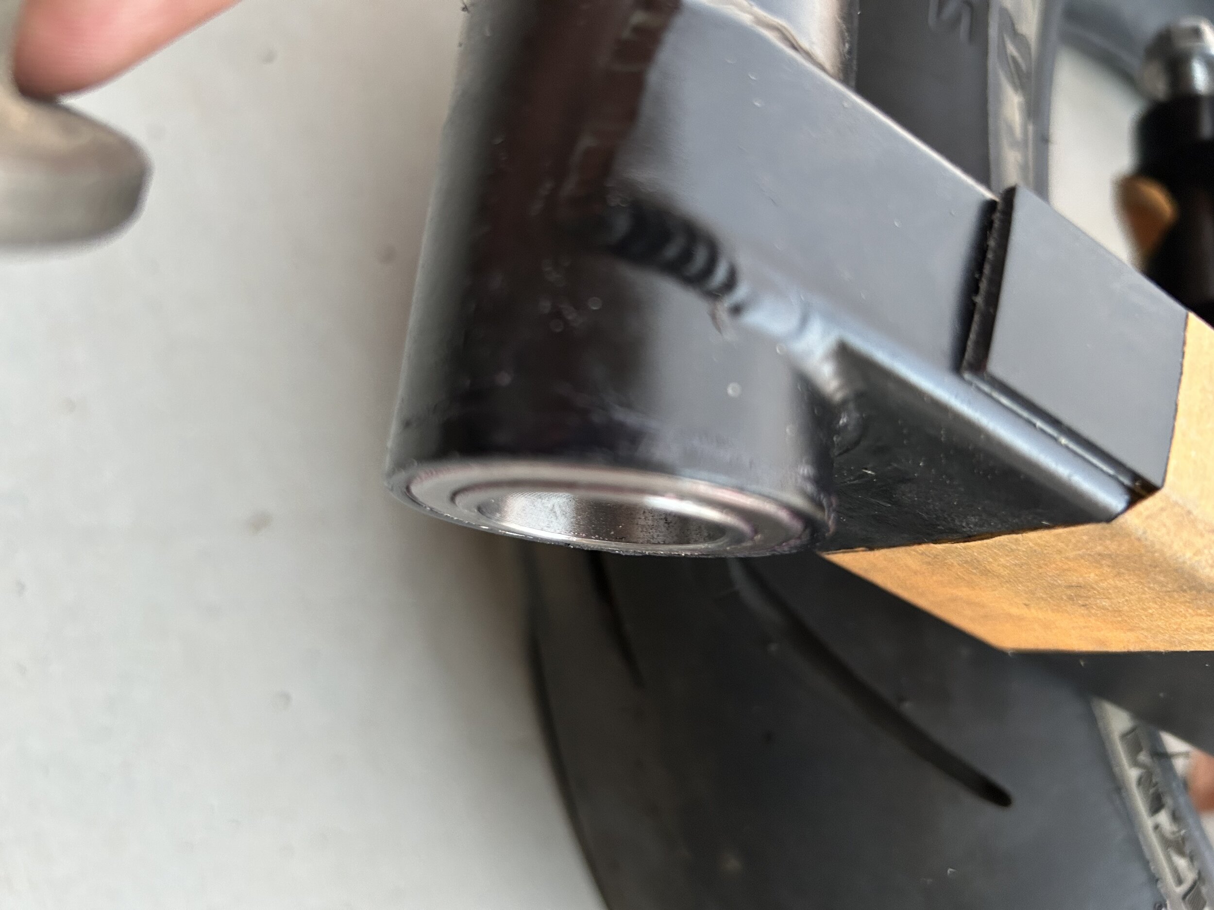

1. Do I need “Pivot Bearings With Crush Sleeves” ? What do they do ?
2. Do I need “ shock Bearings”? I am guessing it’s something related to suspension? I am using stock back suspensions.

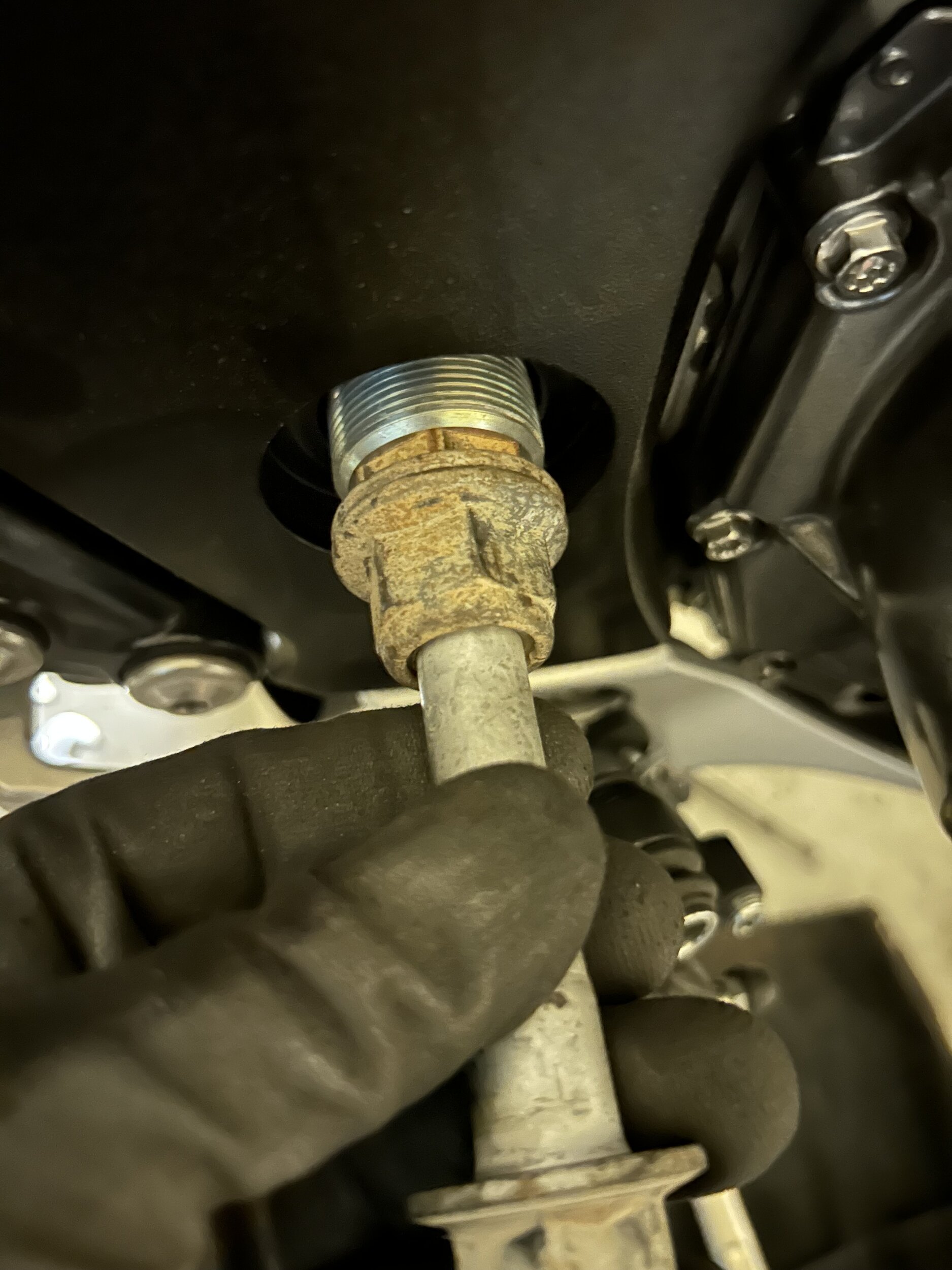

3. Do I need to add “ Brake Line” ? I am guessing it refers to stock brake line is too short for an extended swing arms so it ask me to buy a longer one ?

for questions 1&2: do you plan on removing the bearing from your stock swing arm? if not order the swing arm with the bearings. questions 3 : the stock line is too short, my evil kit came with a longer core moto brake line.

question 6: the white busa in the picture has an evil swingarm. if that is the look then go with evil.

For question 1 and 2, do u mean if I want to remove the stock pivot bearings and shock bearings, then I need to buy them from the website. What do most ppl do ? Do they all buy new bearings when replace to extended swing arm ?
the stock bearings are press fitted and need to be removed if you order with no bearings. i got one with bearings installed but you can reuse the original bearings if they are in good working condition. you still have to reuse the bearings sleeves for the bolts. also you need a special socket to remove the swing arm bolt or have to “make one.”
oh now I fully understand. Thanks for ur patience buddy.

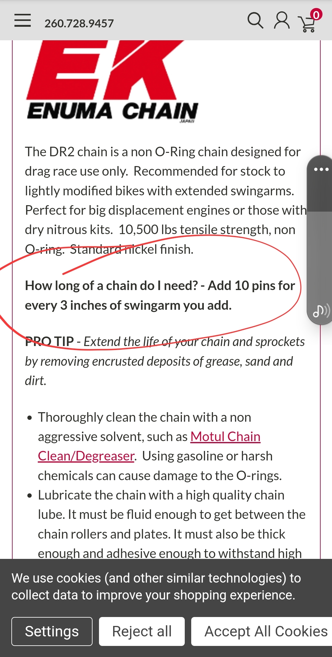

What is the length of the new chain should I order if I wanna extend my bike by 4 inch ? ( 44 vortex and 18 oem)
Remember the wheelbase of the Third Generation busa is 58 inch. @Robert 0046 is the owner for the white busa and he is using 0-4 evil swingarm. So, if you are looking to go over 4 inch which it should be 62 inch total wheelbase. No crush sleeve,No underbracing,No shock bearing is required
