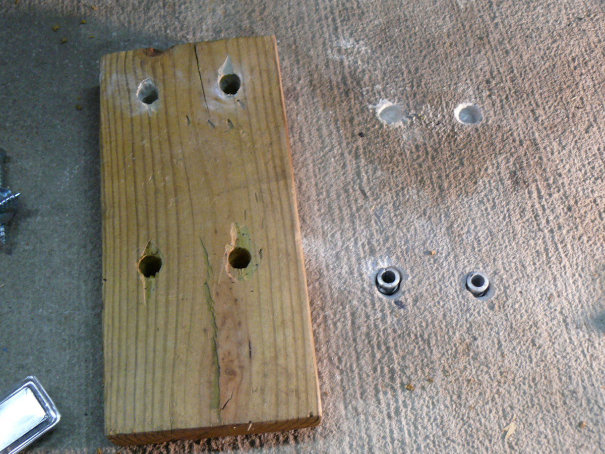

Got my tire changer from No-Mar the other day. I got it within 3 days of ordering it. I am very impressed, with the packaging, looks & construction of the changer. I was also impressed with the detailed instructions, & DVD that came with it. I'm only posting a few pics here. I had too many with this project to post here (I thought). So you can see the full set in the link, I posted below:
It look me a little over an hour to construct. I've already replaced my rear tire, using the machine (I'm posting that in another thread).
