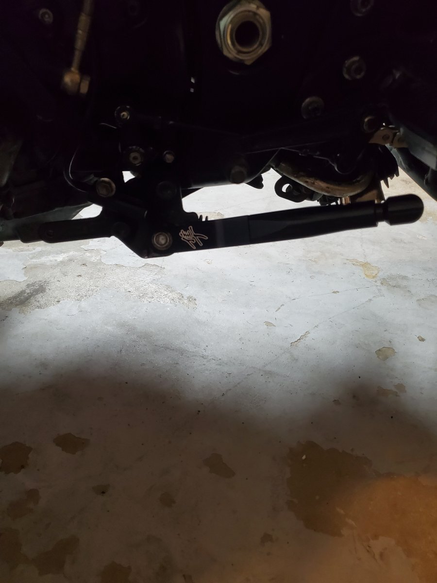

Figured I would start a build/revamp thread on my 2009. I will start with the base pictures as I got it. I have done a bunch of tear down already so i will just dump a bunch of pics here now. Plan is all new plastics, complete retune, new tires, rims, turbo gauges, and I just discovered the fork seals are shot on the left side of the bike really badly. So more to come as I do things.

Today I ordered a new shorter kickstand, a full fairing kit, a full fairing kit bolt and grommet set, new passenger pegs, new rear brake master cylinder, new rear brake fluid holder, front fork rebuild kit, and a new front windscreen. I'm still trying to decide I'm what mirrors I want to run with as well. I think I might have to replace the front brake pads as well due to the fork leaking for a while. And I may replace the rotors as well haven't decided yet.

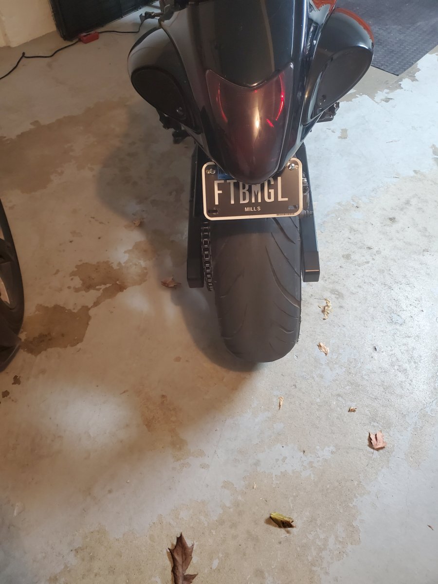

That brings into question the shoes that I need to put on those rims. I'm really looking at the Diablo Corsi lll. Thinking 200/55zr17 on rear and stock size on front. The bike is lowered a decent amount so I want to use the little bit taller tire on the rear to give it just a little bit more pitch forward.

Also if anyone has any input on my tire selection i would love to hear it. I am not opposed to other options both size and brand. I have never run this brand before. Im looking for good stick in corners, but also decent life expecting more wear from the turbo and throttle hand.
