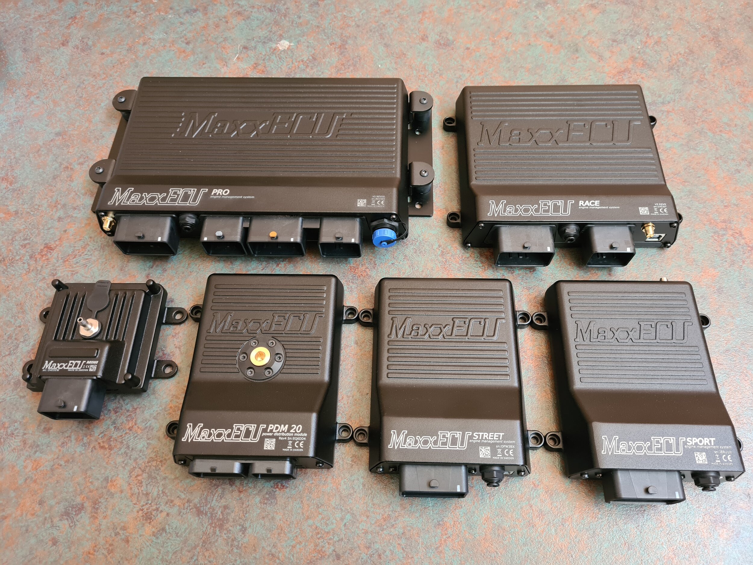

He seems to think he can make it fit, i dunno look at the size comparison, a race fills a stock trunk to the brim IMO

The Pro version is longer, not wider.
Race - 155x195x40mm
Pro - 252x180x40mm

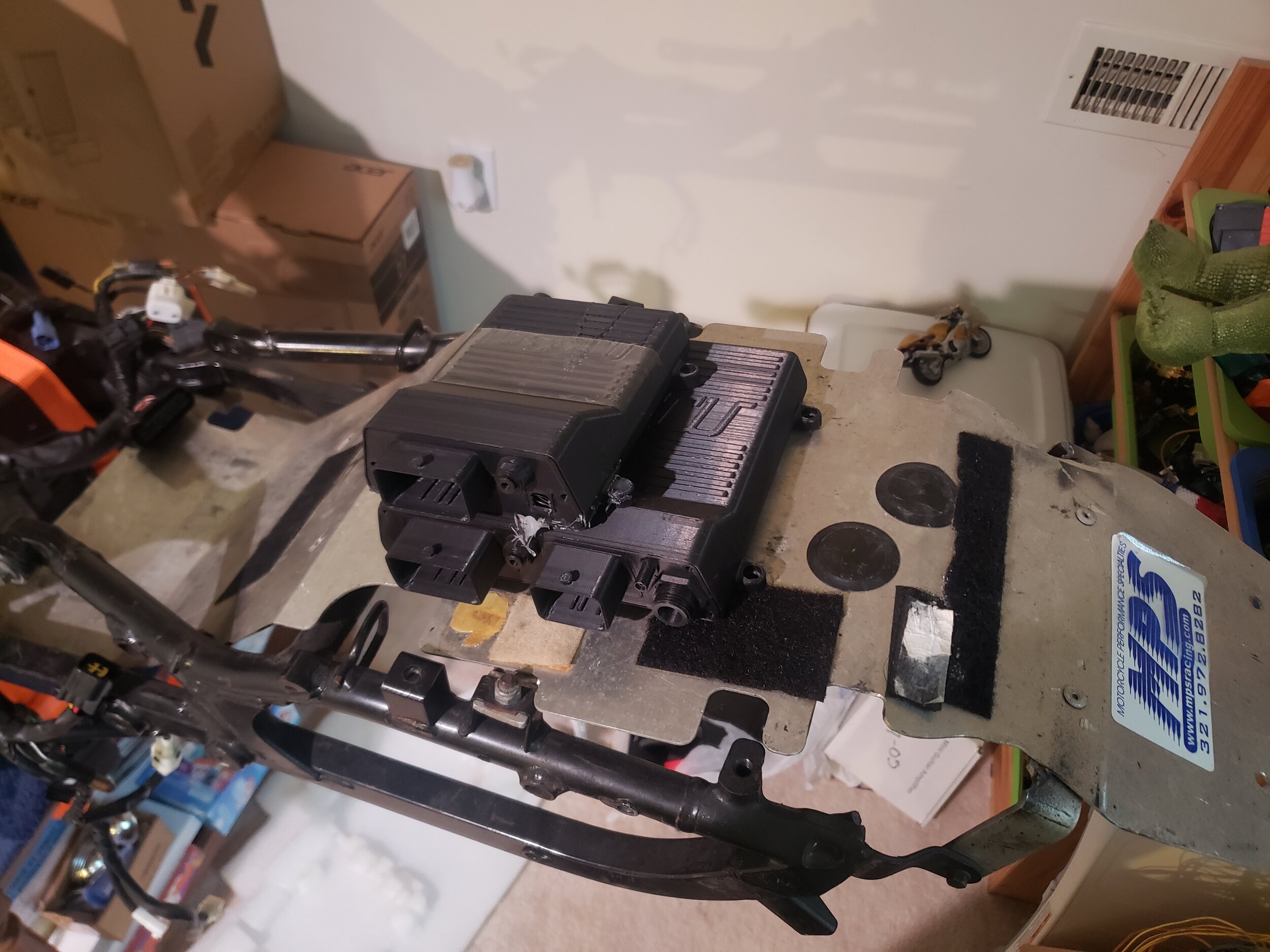

Depends on what you call width, to me width is side to side from connectors etc, depth is front of ecu connector to back where antenna is
Almost all of them I mount sideways like you see in pic to give more room for harness length to make it cleaner
