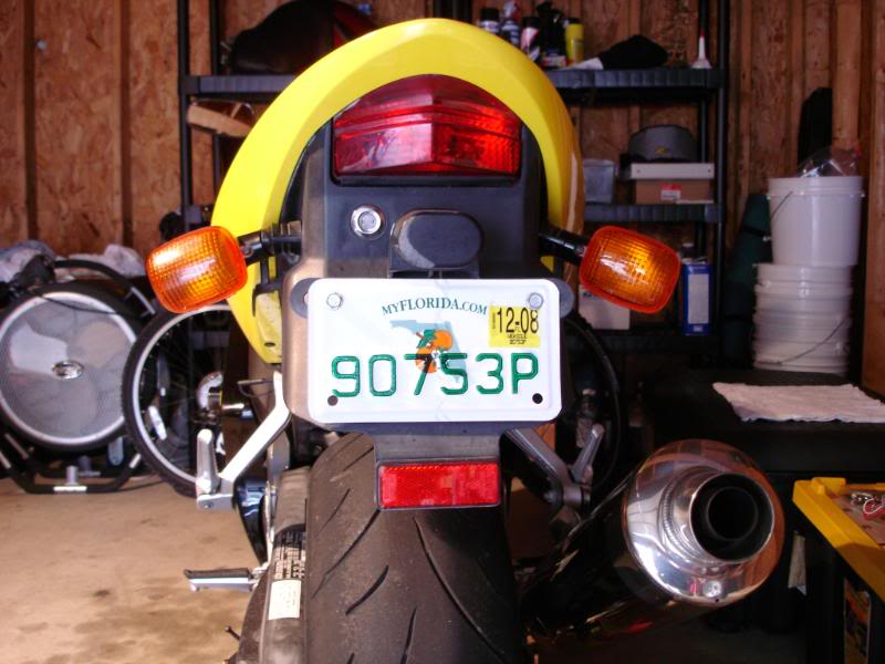

To install a clear alternative integrated tail light, you don't have to remove the tail section.  Just unscrew the two screws that hold the cover on, disconnect the wires for the tail light, connect them to the clear alternative pig tail.  For the blinkers, I unbolted and cut the wires and soldered them to the corresponding turn wires on the clear alternative unit (usually a yellow wire for each side).  You can also use the resistor provided with the clear alternative unit to make sure the blinker rate is slow and not hyper fast.  The resistor goes from the blinker hot to ground, simulates the normal blinker lamp load.
It took me about 45 mintues to do the one of the CBR today, and that one did require removing the tail fairing section.
Of course I have pictures of that one too...
BEFORE>...
AFTER>...
