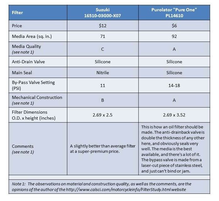

First, I reformatted the table in the CalSci web page to compare only the stock Suzuki filter and the recommended Purolator Filter. Note that some of the data is the opinion of the original author. I added the filter dimensions and the bypass valve pressure to the table, as I think these are relevant. Going through the table, you will see that the Purolator filter is half the price, so this conversion will cost you about $21 with the Bales Tech adapter, and you will reach break even on cost at approximately the second filter change. Cost, however, is a secondary consideration.
AREA OF THE FILTER MEDIA: For a given filter “fabricâ€, the resistance to oil flow will decrease as the area of the filter increases. Thus, a bigger filter will flow more easily, with less pressure drop for a given flow. You will see that the Suzuki filter has 71 sq. in. of media and the Purolator has 92 sq. in. This is a substantial 30% difference.
MEDIA QUALITY: I haven’t torn the filters apart, haven’t examined the filter material under a microscope, and have not assessed the capability of the filter to trap small particles. The rating of “C†for the Suzuki filter and “A: for the Purolator comes from the CalSci website. With that said, Purolator is often considered a top of the line filter. You can read up on that filter here: PureONE Oil Filters
BY-PASS VALVE SETTING: I added this to the table. By-pass valves allow oil to flow to the engine in the event that too much oil pressure is lost across the filter media. This can occur when the engine is cold and the oil is too thick to flow freely. It can also occur when the engine hits peak revs and the oil flow and pressure goes highest and its oiling needs are the greatest. Finally, it can happen when the filter is ridiculously clogged (which will never happen with anybody here on this forum!). Basically, if you could make the filter big enough, you would not need a bypass valve, but since the filter needs to be packaged on the engine somewhere, a bypass valve allows a smaller filter to be used, as most of the time your engine is warm and generally loafing along.

Back to the table, the Suzuki filter is set to bypass at 11 PSI and the Purolator filter is set for 14 to 18 PSI. To be honest, this bothers me a little. Indeed, I had selected a different filter, the Purolator PL14459 which bypasses at 12-14 PSI, but the can OD was too fat to fit past obstructions for installation on my Busa. So now I’m stuck with the higher bypass pressure of the PL14610 filter. This worried me at first, but upon further consideration, this filter has 30% more filter area than the Suzuki filter and is probably less likely to go into bypass in the first place because it should flow more oil for the same pressure drop as the smaller filter. I don’t have any hard data. Lots of people are using this filter on Honda and Kawasaki motorcycles. You’ll have to judge for yourself if this is a mod you want to do.
FILTER DIMENSIONS: The cans of the two filters are the same outside diameter, but you’ll see that the Purolator filter is a full inch longer. I was worried that it wouldn’t fit, but it does fit with room to spare and is quite simple to install.

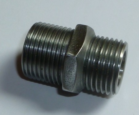

Full installation instructions are given on the Bales Tech website for removing the stock fitting and installing the new adapter.
Bales Technical Service OFA Installation Instructions

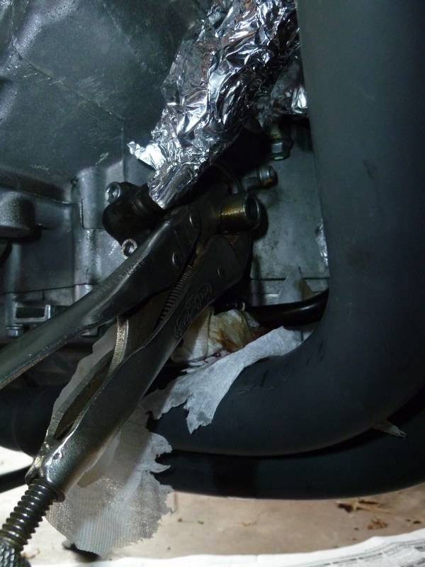

2) At the suggestion of oRg member Wheelsinaz, I heated the fitting with a torch to soften the threadlocker from the OEM installation. I’m not sure this helps, as the fitting cooled off very rapidly after each heating, but it didn’t hurt either. I wrapped the nearby hoses in aluminum foil as a safety precaution in case I hit them with the torch accidently. (which didn’t happen :))
3) There is an oil line in the way and there is no way you’d get a pipe wrench in there without removing it or pulling the exhaust pipes. Instead, use a pair of Vice Grips to grab the threads of the old fitting and wrench it out. I originally grabbed the fitting at the base to save the threads and had successfully broken it free. It did not take all that much force, but it does take continued pressure to remove the fitting and you don’t have a lot of swing with all the plumbing in the way. Rather than risk damaging sealing surfaces on the engine block, I ended up just grabbing the threads of the fitting.
4) Clean the threads before installing the new Bales Tech adapter. I used acetone to help soften the old Loc-Tite.
5) Apply high-strength red Loc-Tite on the threads of the new adapter.
6) I think it takes a 21 mm socket. Torque to 120 in-lbs (10 ft pounds). This is a very light torque and was too light to really feel with my ½â€ drive click-type torque wrench. I ended up using an old 3/8†beam type torque wrench just because I was paranoid about stripping the threads.

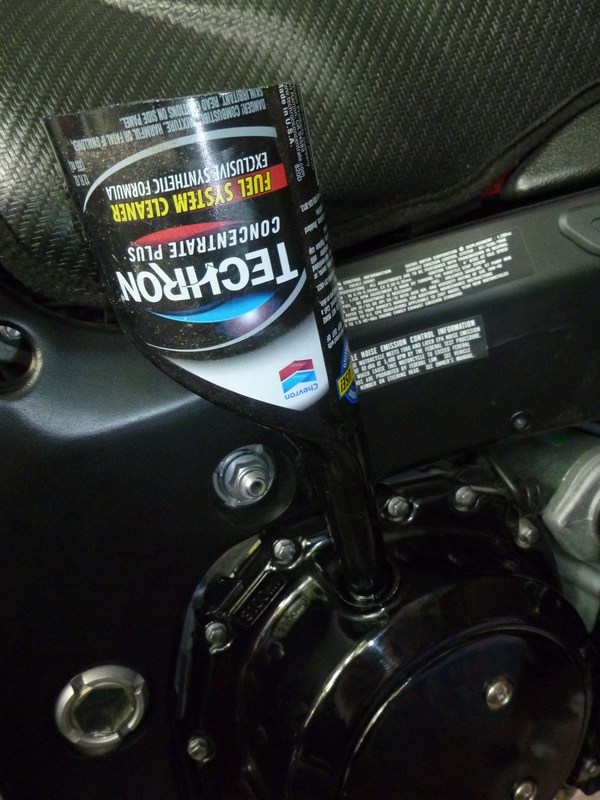

10) I found a perfect funnel for filling with new oil. The threads on the Techron bottle aren’t a perfect match, but they screw in very firmly into the oil filler hole. Best funnel I’ve found yet!
So that’s all of it. I think this is an acceptable mod. I’m not making a yeah or nay recommendation. That decision is entirely up to you. All I’ve done here is definitively shown it can be done to a Gen I Busa and try to give some technical details. - AJ

Well I will keep track of this and be sure and get your up to date opinion if I choose to do this... The part that scares me is the vice grip on the stock threads... What if I cant get the stock one out? Oops crunched threads! :banghead:.
That was the first things that came to my mind.... The horror....
That was one of wheelinaz's concerns too, and why I heated it with a torch. It actually came out pretty easily. The biggest problem was the short amount you could turn the wrench (vice grips) between the oil line in front and the exhaust pipes. Really, was quite easy to do.
