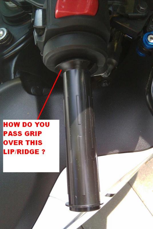

How do you get throttle grip over larger ridge not the one on the end but other end of tube next to killswitch ?

Very nice .
Again.

I'm guessing that the grip just sits up against that ridge Blanca. I have not personally changed grips, but that would be my best guess.
Yes you are correct as there is no inside channel on that end of the grip.

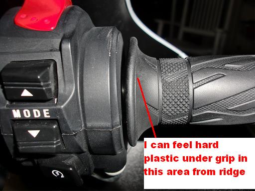

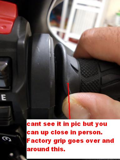

Wayne the larger ridge closer to killswitch does goes inside of factory grip.
I can feel it right under the grip end.
Also its diff to capture in pic without rolling it back but you can see it if you just roll grip back a bit like I am doing in second pic.
So again I'm curious how you overcame this or got it around ridge ?

Bumping this old thread for help. I am also not seeing how to get the end of the throttle grip over the ridge near the kill switch. Unlike the OP's pictures, mine is not a nice black conical ridge either. Its a gnarly plastic piece that the factory grip was damn near integrated to.

Best you can hope for w the aftermarket grips is to sit right up against it bro..no ridge for it to sit into on the new ones..

I took a dermel with the sandpaper bit and sanded it off. Then used the air compressor method unclesteve talked about.

What I had to to to make it work was cut/sand off that little ridge. I used razor and sandpaper. There was no way the d3 was going to slide on without removing it. When sliding on grip, one thing to remember is to slide it all the way up. The inner most ridge next to the kill switch won't be covered by the D3 grip but you can slide/compress the rubber part just enough to get it all the way on so that you can install the bar end back on. Just keep twisting forward and pushing it in. no problem. I had to try install/uninstall multiple times to get it right but now its perfect.:thumbsup:
