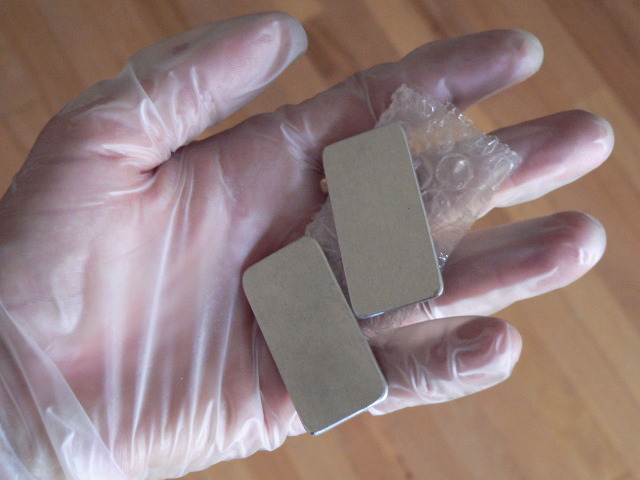

Installed this system on my 2008 ZX-14 a few years back but I will have a few questions. Thought I would just post on this thread rather than start another.
Have rad and oil cooler off.
Have removed entire OEM exhaust. Tsukigi Cannon is waiting to go on.
Removed OEM exhaust gaskets. Have new Schnitz gaskets waiting.
#1 There are two aluminum clearance plates included with the kit. Where do the clearance plates get installed?
#2 The kit includes an oil cooler bracket. Any idea why the OEM oil cooler bracket should not be used?
#3 The headpipes are numbered in reverse order if I am not mistaken. Isn't the head pipe on the front brake lever side normally considered number 1 and the clutch lever side #4?
#4 Looks to me like the HO2 bung has been welded in a poor position only receiving flow from the two right cylinders. I will be installing a Bazzaz Z-AFM (self mapping). Should I plan on getting the O2 bung welded a few inches back at the collector where all cylinders' exhaust can be sampled?
Mythos
Feb 4, 2009
5,223
7,088
Pipe is on.
#1 The plates are supposed to be some sorta feeler gauges for clearance between pipes and oil pan, I guess. Not very useful.
#2 OEM oil cooler bracket is just fine. I left it on. Only thing I can figure is they include the aftermarket bracket in case you might need a couple extra mm of clearance. You could bend the one include dwith the kit to make it longer---I'd just fab up a new one but I had plenty of clearance between headpipes and oil cooler.
#3 The headpipes are numbered in reverse order. I suppose you can just ignore the stamped #s on the pipes if it is too confusing.
#4 The o2 bung is welded in a position that would appropriate for use with the OEM sensor. OEM sensor of no use with an aftermarket system. They made a mistake when they welded the bung in my pipe. Was NOT done by Tsukigi. Bazzaz directions say to weld the bung right after the collector. So I will be having it re-welded when I install the AFR module.
