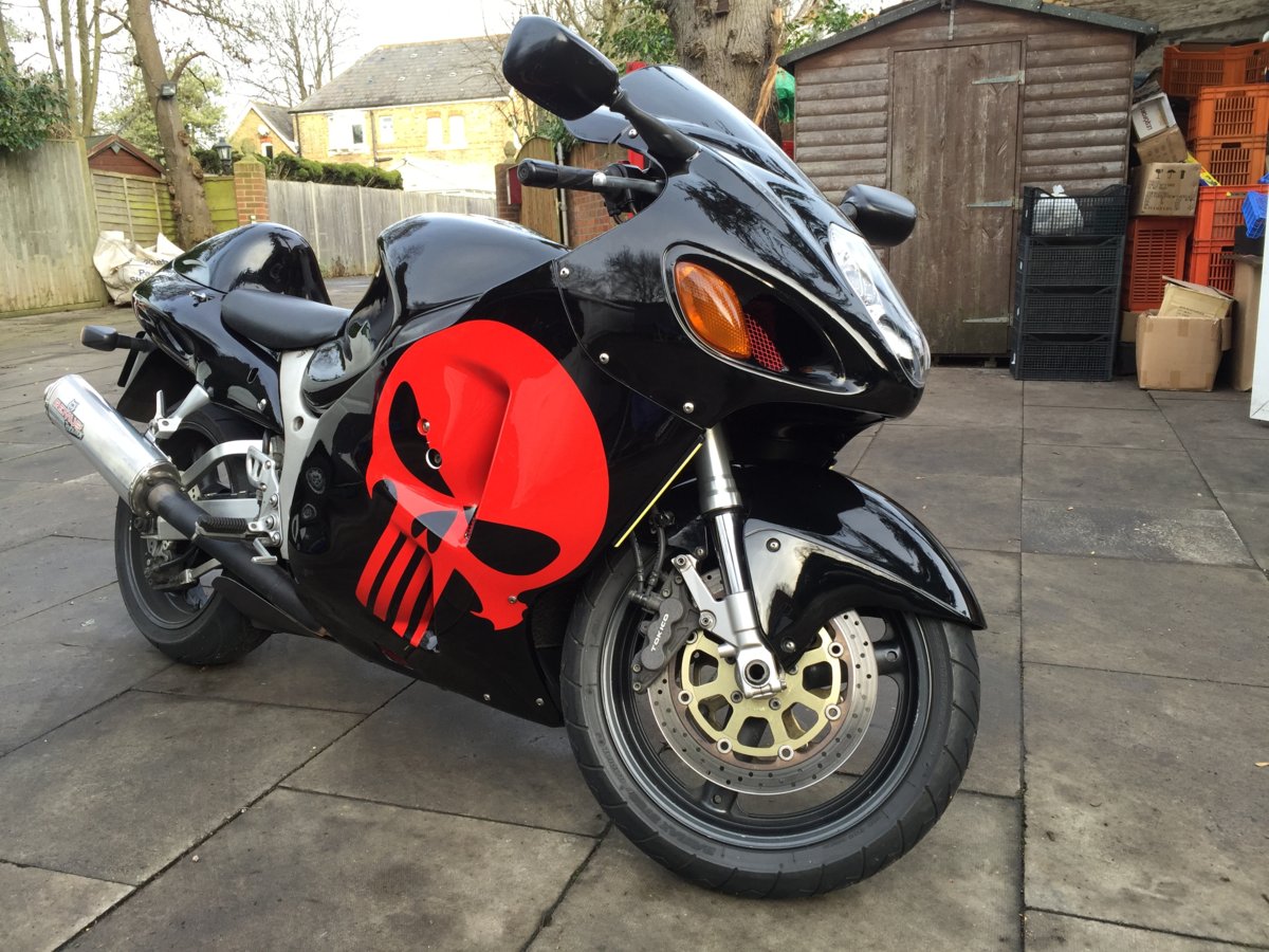

New cloths, with the new lease of life.

haha Punisher! Looks awesome man. You gotta do some moto vlogs!
The kit was cheap Shaun, I love the black, never played the game though but it's grown on me, got to get some tasteful decals to break up the black.

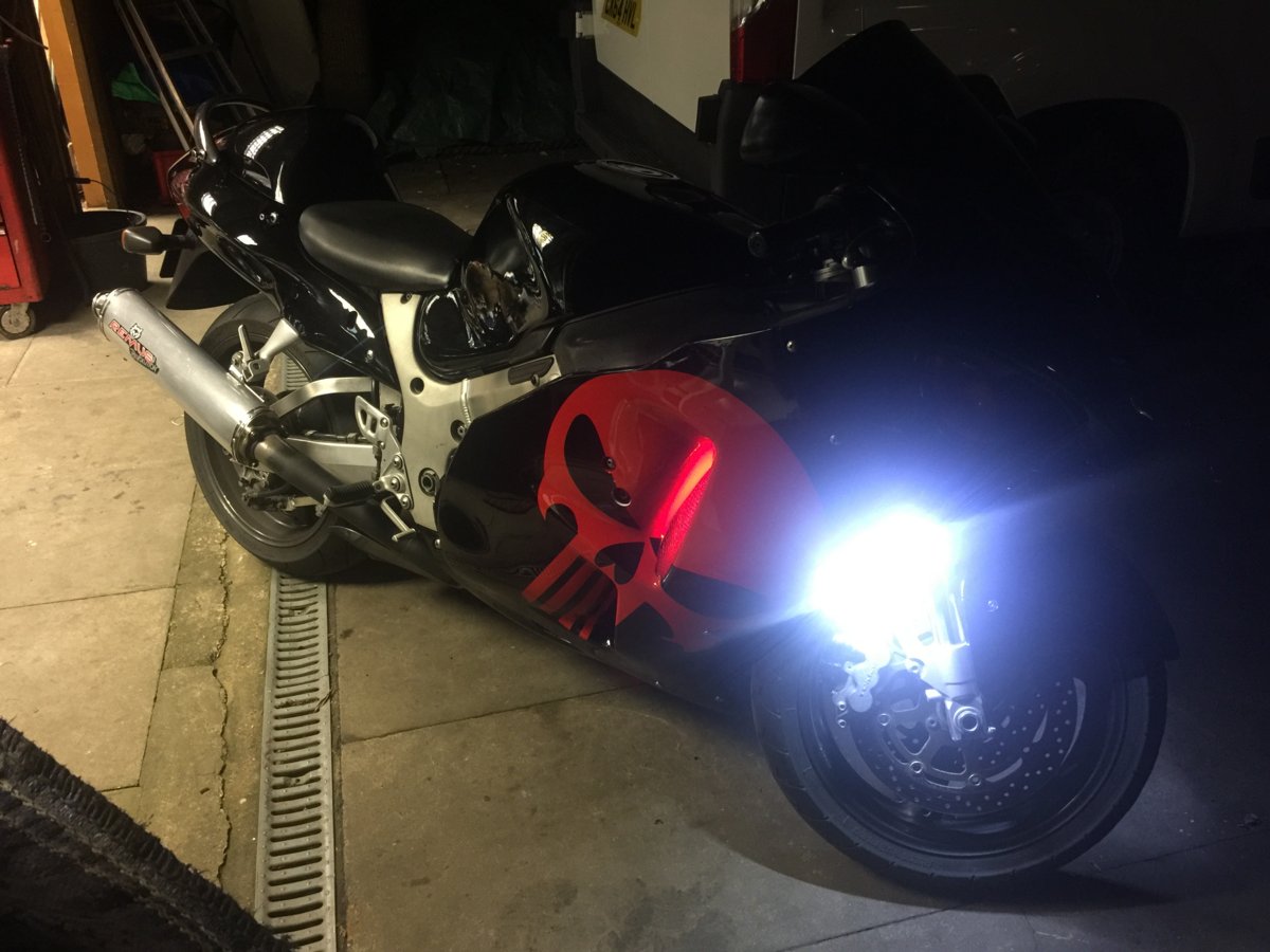

What IS that light? Is that an LED on your fairing?

Led's, they were fitted to the fairing when I bought it, so I thought I may as well get them working, I think they actually look quite good, not too tacky.
I just need to sort out some decent decals/stickers now, to go with the look and break up the black a little.
