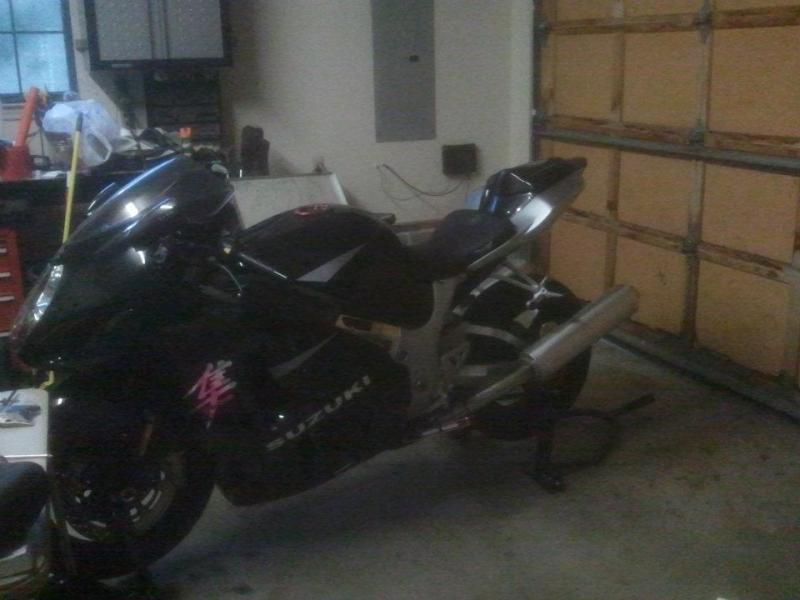

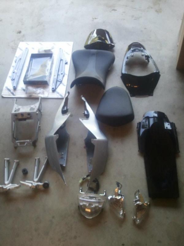

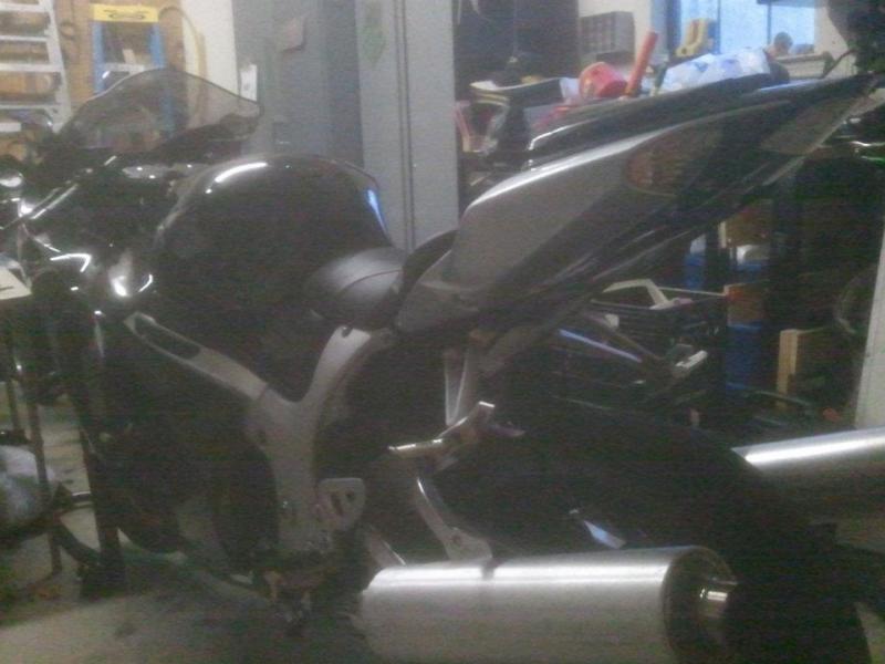

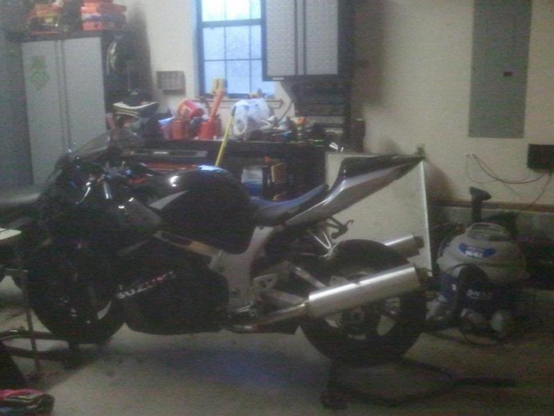

Took quite a while to get these finished and put on. Ran into a few problems but here it is, start to finish, complete and running. Thanks to Jon Reed from Greggs Customs for the parts and help.

Thanks all, I love it, I know some people aren't too fond of it but its mine so I ccan do whatever I please :laugh:
It wasn't too bad to do, only took about 6 hours total work. When I bought the kit there were a few things missing, I had to go out and buy. I'll make a list of all the parts I got with the kit and little things i had to buy that didnt come with it.
Kit:GC Hayabusa to GSXR Subframe conversion kit in Black, Complete plastics, lamps, pillion box, Corbin Matching rear seat, Stock rear pegs and brackets
Seperate Parts:GSXR 1000 seat lock cable - seat lock plate - wiring harness (Busa not same as GSXR) and a longer battery cable.
Changes: Relocate tip over sensor, the footpeg brackets don't match stock exhaust so you can either get different mounting brackets or exhaust (I went with a Brock Alienhead and will put pics up when it gets put on)
This is all I can remember. Total for all the parts and shipping it was about $2k. If anyone ever decides to do it I'm happy to answer any questions since I know I had a lot getting it together.

I mainly did it for the looks, I'm not a huge fan of the hump on the back and enjoy the GSXR tail. Right now it is pretty high up but I will be putting lowering links on it and a different exhaust. It does help with performance by making it lighter, but i'm no knee dragger(yet!) Just did it for personal pleasure. I'm probably going to take the Kanji off and do a flat black and red look, might put the 1300R on the tail. That'll really throw em off!

Thanks :thumbsup: I have a Brocks Alienhead that I am going to put on, I only got to ride once and then went out of town but it was nice. I'm in the military stationed in TX and its back home in TN. I will be heading back in January though to finish it up and bring it down to Texas with me.

Yeh, looking for a stubby 4-1, will then get a bracket welded to hold it on the front footpeg holder, paint all done, just not got all the panels on yet, Cheers!
