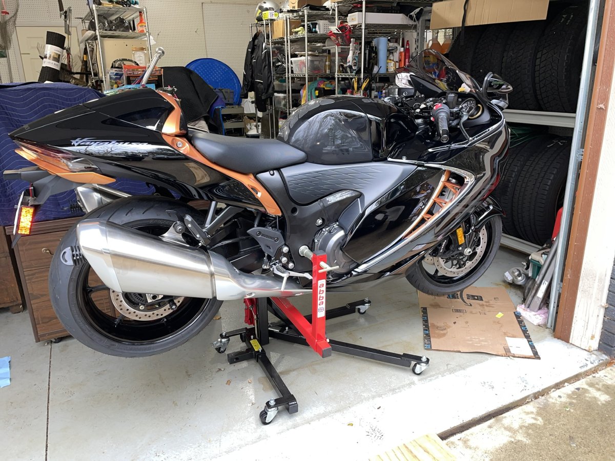

I found the access hole, you mentioned a Phillips head screw. Just making sure as tried a Phillips head and I think I’m in the slot but didn’t want to force something and break it. Just double checking before I go turning something.

Here ya go!

High beam nice and bright even in day time, low beam fine at night, I’m sure it’s just adjusted too low because I weigh 255 pounds, Sunday I turned on the headlight and turned the adjustment screw about 1-1/2 turns and I saw the beam move up a bit on my garage door. I’ll see how it does. Thanks to SS4Luck for his post on instructions.
