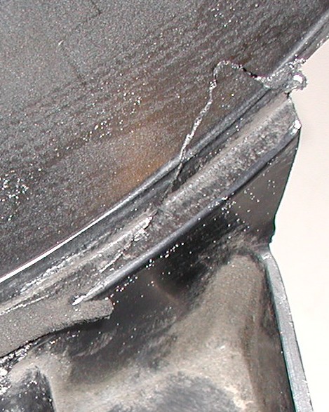

my hint for preparation and processing :
- you have to "close" the seam´s backside with a thin painters tape to prevent that the powder can "fall" trough.

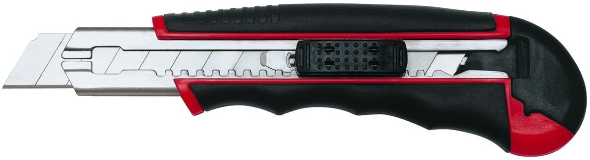

- you will get the best results with both adhesives (technovit & loctite) if you bevel the edges of the crack / breaking edge so that a ~ 2/3 depth seam is produced that has the shape of a Y.
see pic (no tape yet on the backside)
cut made with such a cutter knife
and
when the glue has hardened, for best stability you should also cut the other (back) side of the seam in a V-shape .
a rear side - not cut yet.
you also can use a "Dremel" (instead of cutter) but then you have to pay big attention not to abrase to much / too deep.
