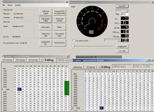

Wow this stuff is cool....got home today and tried what you said and within 5 minutes I had gauge data working, and flashed me ECU for the first time, 11,200 RPM limiter with no 6th gear restriction (comes on at about 11,600 RPM) actual....How Cool :)
Here are a couple of pics of the cable and switch etc I put it in a box and added a couple of LEDs
Red comes on with power
Green LED means gauge data mode selected
Blue LED means flashing mode selected :)
I have it so i can remove the box from the bike by just unplugging the 6 pin molex connector I put on there.
I am geeked, gotta get the shift light programmed from the flapper solenoid and get the kill box going for air shifter :)
Possibilities are crazy with no extra hardware on the bike
Remove 6th gear restriction
Change Rev Limiters
Change Fuel Tables
Change Ignition Tables
Window Switch for NOS operation or Shift Light etc
Switchable maps for NOS etc
Etc
Etc
Etc
All just by flashing the ECU, too cool

Well....it works :) There is a whole forum dedicated to hacking these ecu's :)
Also can serve as an ignition kill box, autoshift etc

software is all available online through bikeland etc, i can get links for you
Kit is pretty much ready now, thinking in the $125 range for it, i would like to donate $25 or so from each unit to the DaveO fund as he was a huge part of all this.
No datalogging though, not enough ram on the ecu to do that.

Ecu editor by petrik
I can set up a link later today
