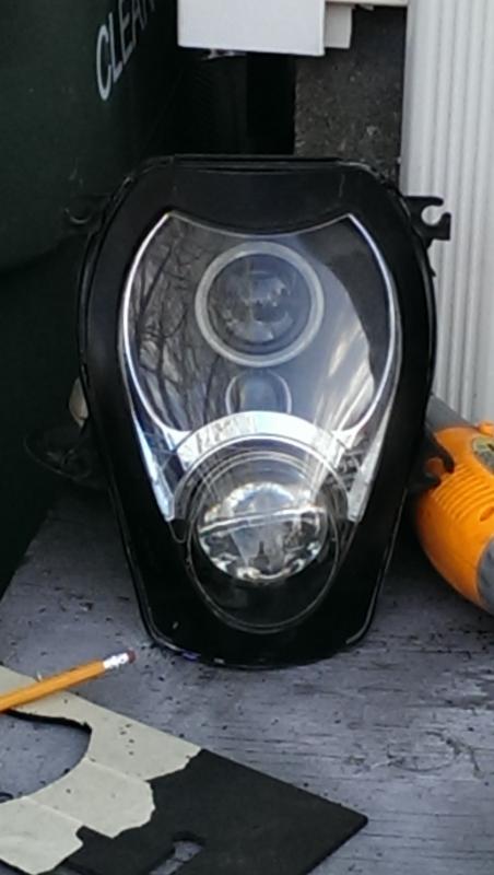

Where did the headlight assembly come from? Looks good!

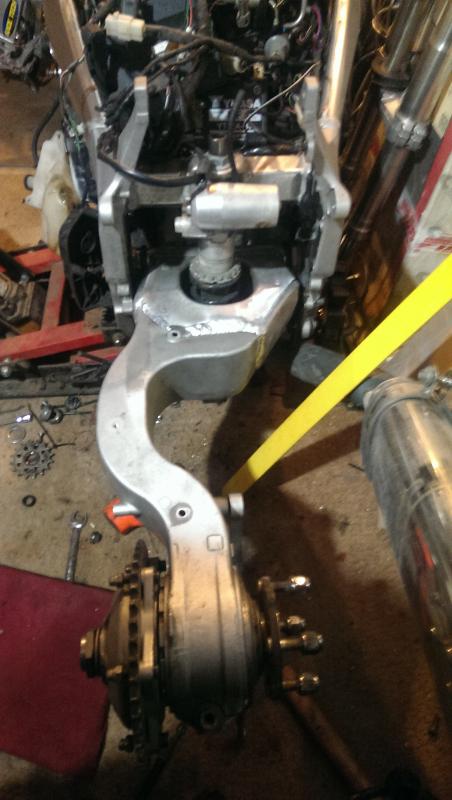

Tell us more about the rear wheel and the swingarm. Can we see it from the other side? That tail looks good.

sorry about that it is not 100% finished the headlight projector came from a broken R6 head light the adjusters lined up almost perfect and i just made a ABS surround so you cant see the adjusters the arm is VFR800 I cut the pivot mounts off and used a SRAD 600 front pivot and snd shock mount and had it welded by a airplane welder vfr was inserted into 600 so that i wouldnt worry about any breaking dont want to play with my life for good looks Ill post more pics soon

couple of the swingarm test fitting on SRAD frame for chain alignment, when i put on Busa I had to use 750 shock and im oing to move arm to the left another 1/4 inch with offset front sprocket to try and get tire as center as possible its of about an 1/8th it doesnt hit peg brackets at all ill put up left side when i get chain and sprocket on and rear brake

correction on headlight it is from 07 R1 not R6 i just order another headlight i might sell one with echange not 100% on selling ill post if i decide to sell one

i have a 240 Shinko tire with custom vfr800 arm i couldnt spend the money for the marvex arm and i wanted the 240 with arm as close to stock length as possible but yours is nice no doubt if i could i would but im broke lol
