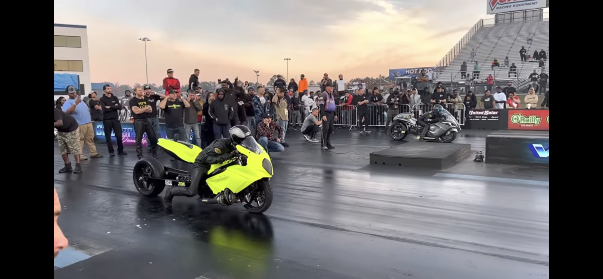

Can I add it also baffles me that people don’t take his cue of body position on the start line. This is what the fastest in the world does so why people sit with their feet forward makes no sense to me. The fastest guy puts his feet behind him and tip toes to the line. I’ll do the same.

Depends on the class and the bike, bars, no bars, and other stuff. In eliminations with stuff set up on kill or some Sliders, some turbo stuff, u have your feet in front in case the clutch starts to creep u can hold it back before it pulls you thru the lights, bcuz from experience your toes won’t stop u lol
He makes great videos too, being mic’d up makes it way more entertaining

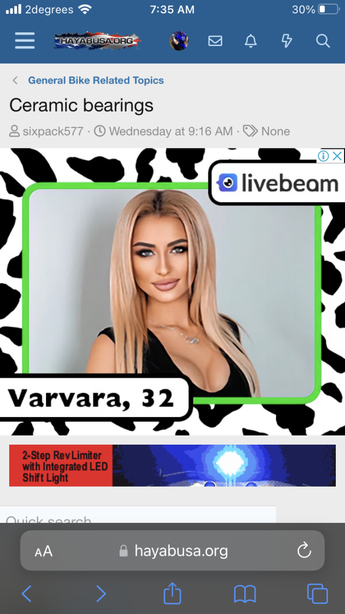

Yeah, I’m bored with all the tech talk now…
How about this, ya think this one’s real?
Photoshopped much lmao??
Carry on folks, don’t mind me, I’m just sitting in the corner distracted lol.
This is the crap I’ve gotta put up with while trying to concentrate on the physics of wheel bearings!

And
Varvara is Barbara with a Chinese accent...there's alot going on here...
lol
