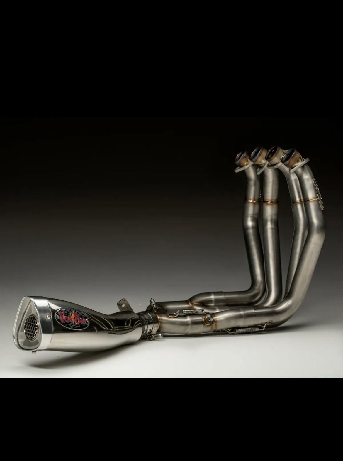

A Voodoo shorty is a bit too loud for my taste. Can I replace just the muffler/can with something quieter without replacing the entire system?
Does it have to be a Voodoo product or could I use another brand?
I have an email in to Voodoo but no response so far.

Without seeing the system I'd guess attachment will be the issue. Consider a custom mid-pipe if you can't find a matching diameter for a slip on. Pretty sure the exhaust system wouldn't care what is attached to it but likely the AFR will change and that could be important, perhaps even critical.

Yes, my stock mid pipe fit perfect on my voodoo header. I bolted a cut D&D can to that. With that being said any slip on system (right side) should fit nicely.

u can leave the header alone so incase u want to sell the full system it will be easier to do so. just have an exh shop make u a mid pipe. use can use a muffler that has a sliding muffler clamp. makes it easy to modify.

I’m expecting to get the same response from them as you got. And maybe as Hayawakened pointed out, changing the can might mess with the AFR.
Just to fill out the story, I’m in the market for a used Gen 3 here in CA.
There’s a 2022 at a dealership with only 540 ( yes, 540) miles on the clock. It has a Voodoo shorty exhaust which is a bit too loud and is ugly looking IMO so I’d want to switch it out. The price is good though.
Aftermarket exhausts in CA are a no-no but the police don’t really enforce that.
The problem is getting an exhaust shipped to CA and finding a shop to install it due to the crazy emission laws out here.
It would easier (and cheaper) to buy and replace just the can but it’s looking like that might require some fabrication to get it to fit.

Just heard back from Voodoo on this question.
FYI see below
We do not offer a quieter muffler that works with our Shorty full systems. The only thing that I can suggest is our Phantom Core that will quiet the exhaust by 4-7 db. Link below.
