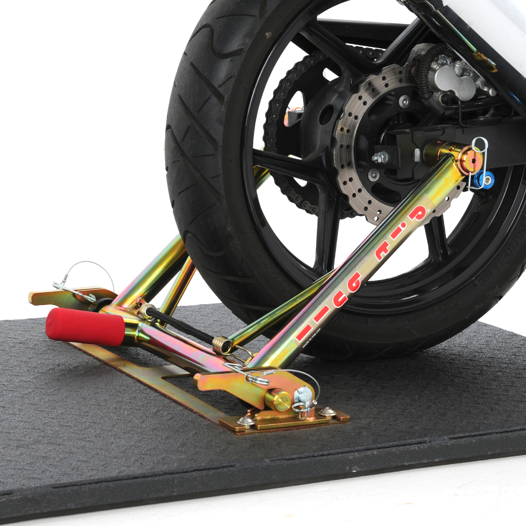

Tried all sorts of webbed tie-down solutions for inside a van. The Pit Bull TRS @bigoltool mentions above, at about $400 USD (excluding the bike-specific axle pins) is worth every penny. Roll the bike in, lock it down, you're done. LOVE this config. Won't go back. One system, multiple bikes. Axle pins cost about $50.
EDIT: I mean one system, multiple bikes, but one bike at a time:firing:
EDIT02: The DIY plywood allows me to pull the whole system out of the van and no holes drilled into the floor

You can attach the TRS axle component to the bike while it's on a rear stand. That's what the (included) bungy is for: pop the unit into the axle then pivot up and attach to something so you can wheel the bike around. There's a bunch of vids
LOL yeah I still got a kickstand. I'm more like a wannabe track rider. Ran those teflon Michelin's in the pic at the track

If you're talking about the Pit Bull Trailer Restraint, you hold the bike up. The stand is already attached to the bike and held up by the included bungee. You just unhook the bungee and lower it and it will slide right into the locks. I wouldn't try to ride up the ramp with the bike, just push it up. It's easy if your park the trailer on a small decline but anyone can push a busa up a trailer ramp with a quick walking pace before you get there. You could ride it up if your weight doesn't compress the suspension so much you hit the bike as you're going over the top of the ramp. Then get off and lower the bar into the clamps. It's not easy to get the bike lined up perfectly so that the trailer restraint locks right in but you get the hang of it. Just don't back down the ramp with the stand lowered, it has little wheels so you can roll it behind the bike. If you back down the ramp with the stand lowered off teh bungee, the handle will scrape the pavement. You can roll up with the stand lowered just don't roll back down unless you raise the stand and bungee it.
