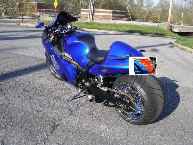

Here is my photo chop of seeing what it would look like. Would take some body modding to do it and would lengthen the tail about 3 inches.
