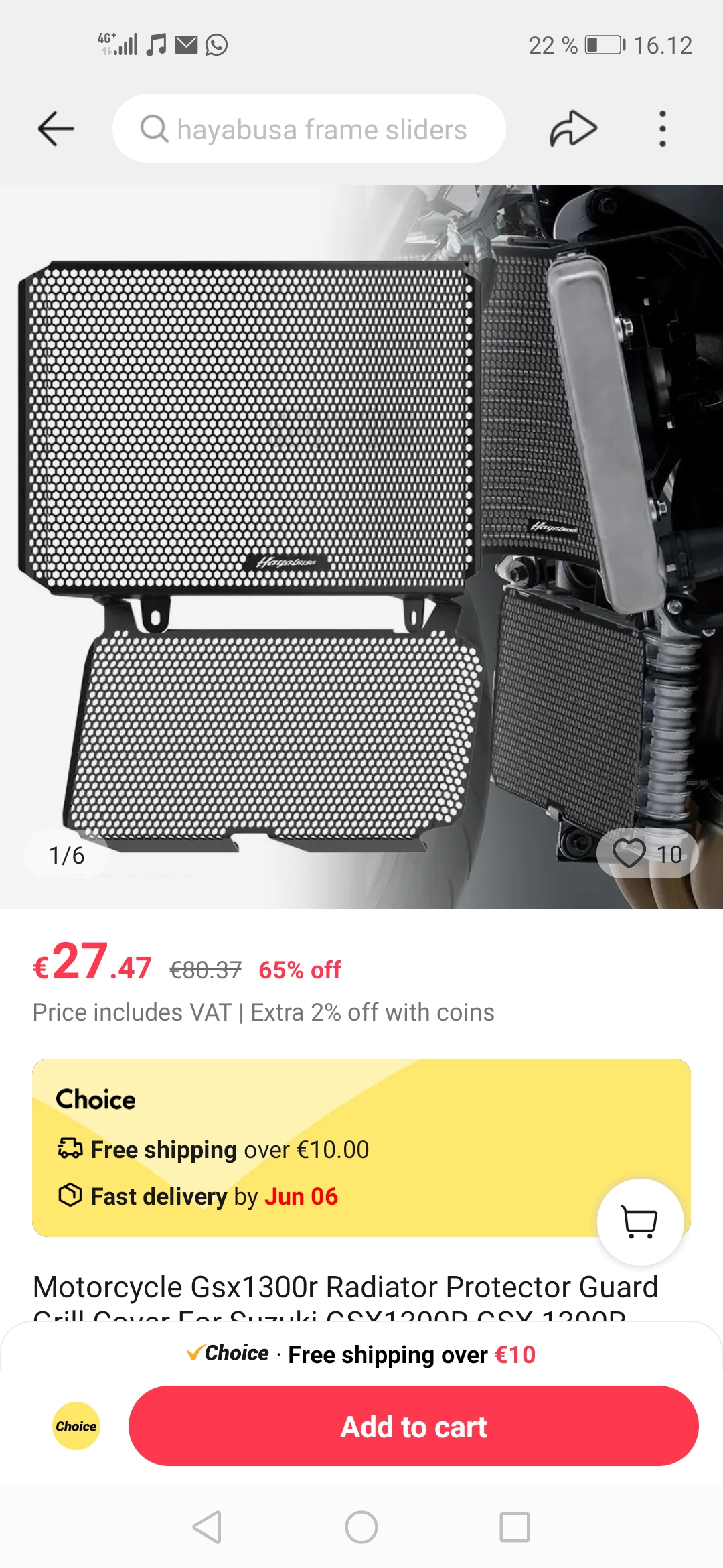

Guard is from aliexpress.. Remains to see if it's any good.. But looks pretty deasent in pictures.

The rad guard from AliExpress looks good too . . I've bought rad and oil cooler guards from them before, pretty good, fit and finish is good, they are value for the money paid.

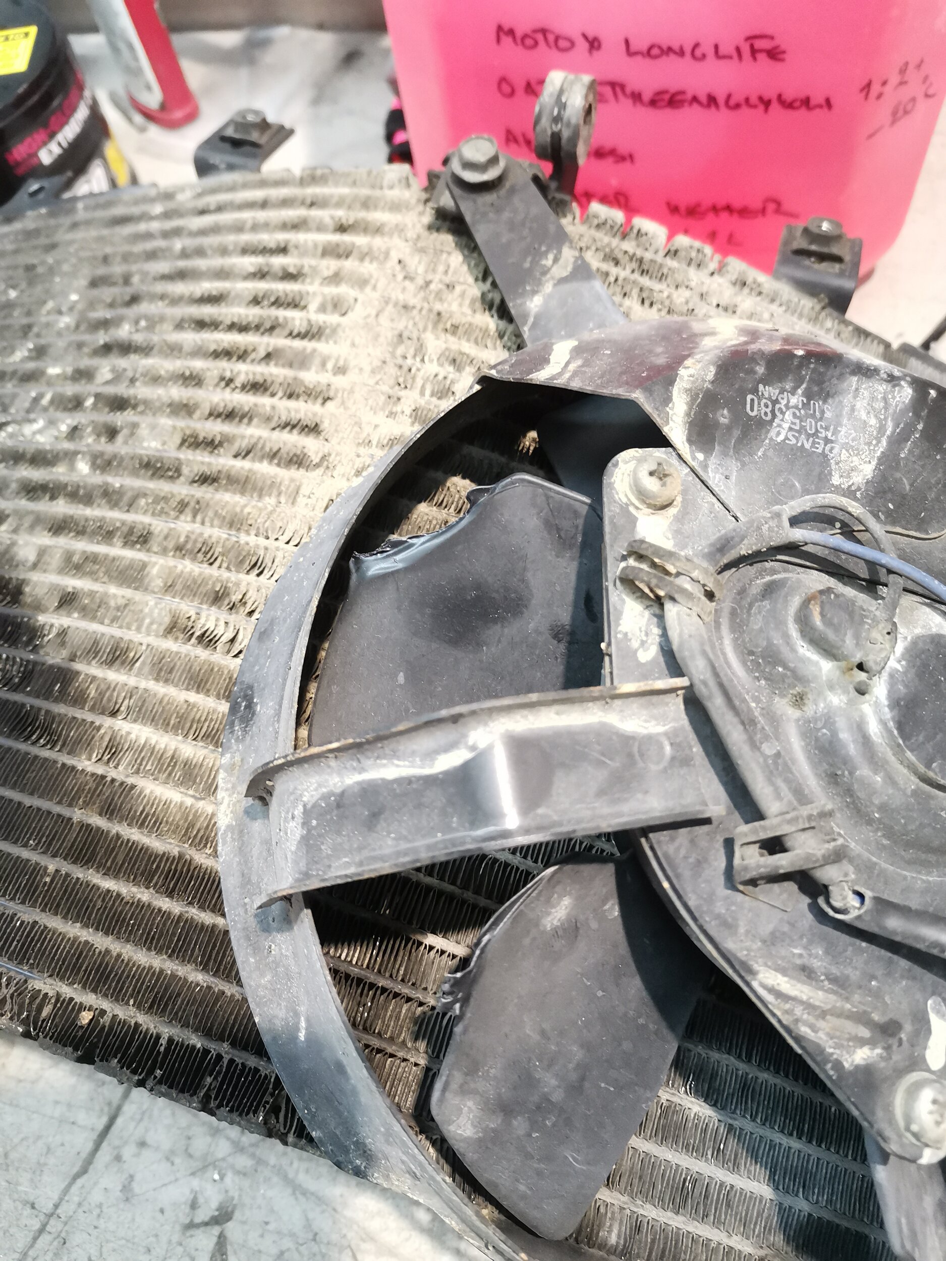

Still waiting the radiator.. I had time so desidet to take old radiator off.. Only one bolt gave me a hard time, (pretty good i think, maybe wd 40 did the tric.) one that snapped I was able to drill off quite easyly and make new tred. So all ok so far.

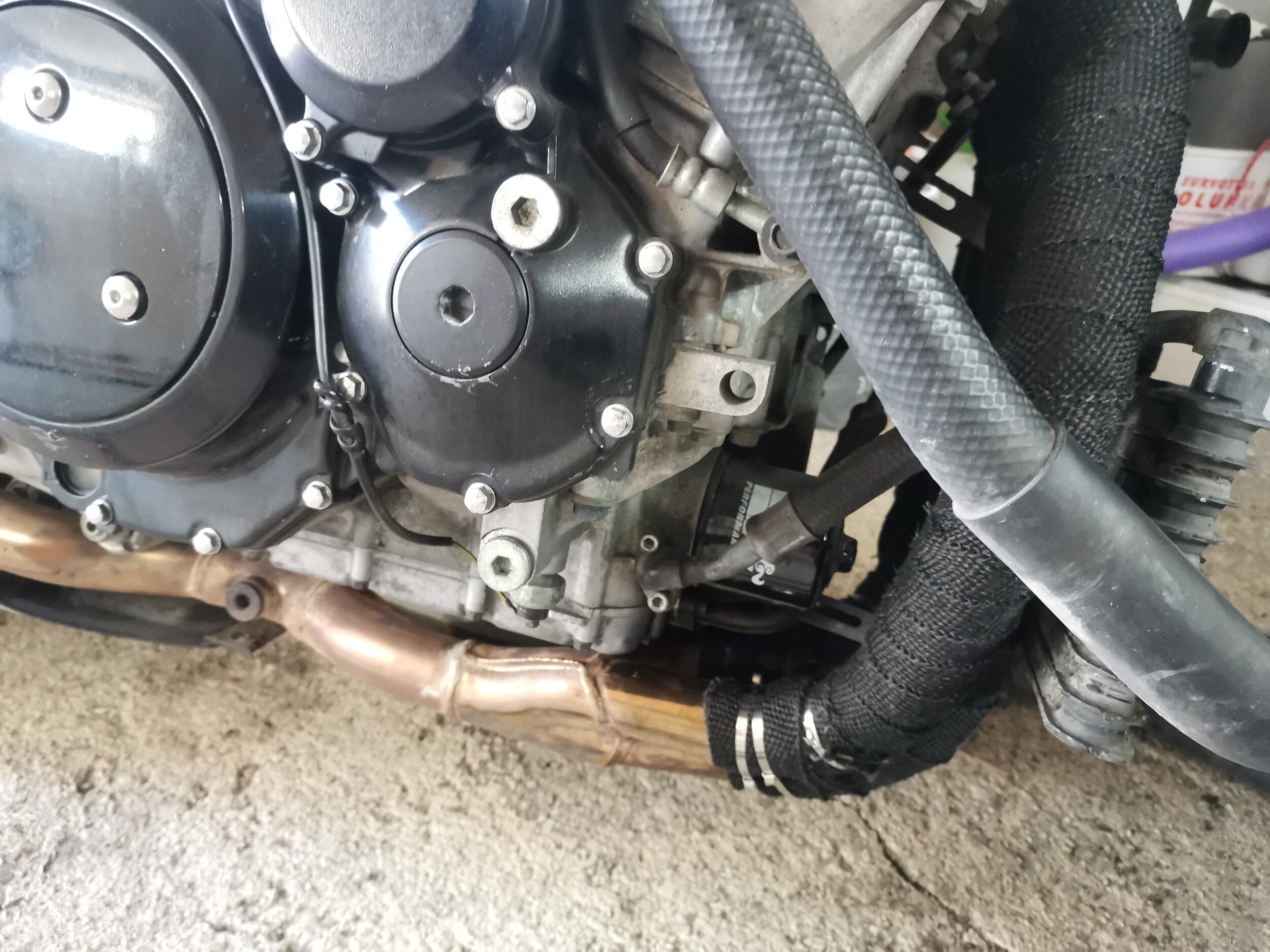

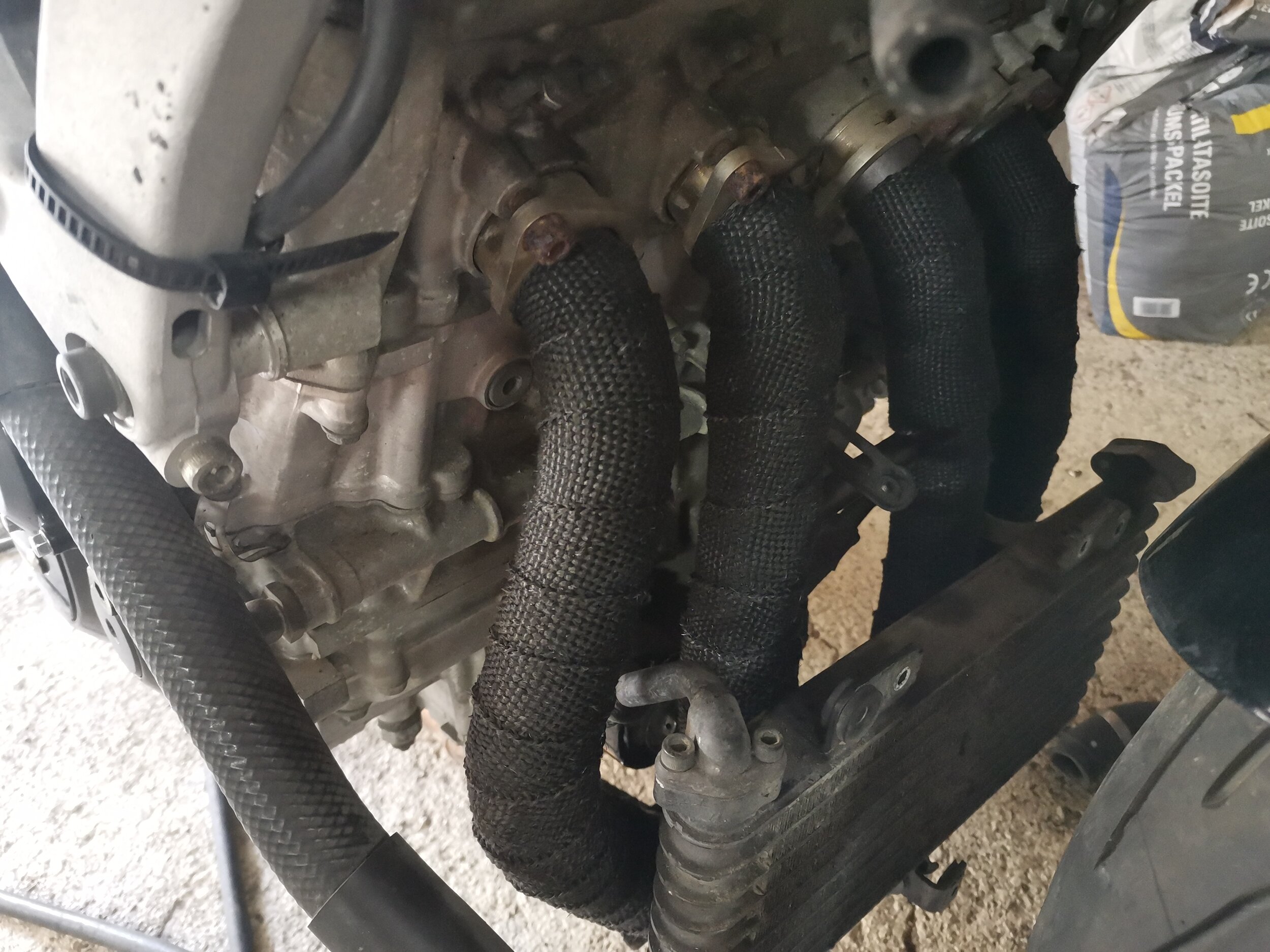

Now while i have radiator off the way I desited to make heat wrapping allso, any thougts of that? Shoud make some difference to heat radiation and rust the pipes?? In pics reason why to wrap..
Anyone else had same kind of melting in coolingfan?

The thermal insulation of the exhaust pipes seems to work too, significantly less heat rises from the engine bay when stopping.
