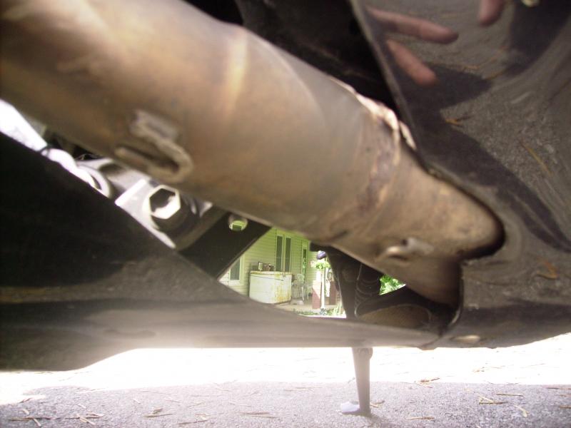

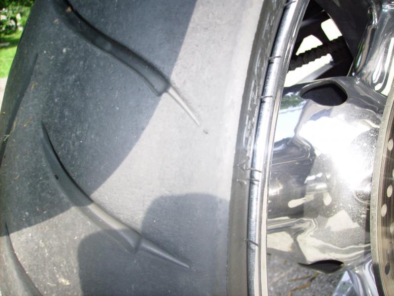

So my question is, how is it possible to lean more when your bike is already scraping the ground. In the pics you can see the wear looks mostly about 1/4 inch up but its rough until about 1/16 maybe (cheap camera). I was riding with about 10 guys today and with me scraping the exhaust and pegs I was still getting left behind? My bike is lowered 1 1/2 inches and I was riding 2 up, I know that could be a reason for alot of it but if the tire is all the way on the side how do you get more? Is it the lane I am taking? I go outside inside outside. I followed the lane of the people infront of me until they were so far I couldn't see them. I was not up to trying new ideas or getting out of my comfort zone with a passenger, but I figure I could get a little help from here.

The exhaust pic is blurry but you can see where the upper ear for the spring was scraped. There is a little on the can but its so small my camera couldn't get a good pic. Everytime I heard it scrape I raised it back up a little. Another thing is this is the first time the exhaust would scrape before the pegs, is that because of the passenger?

Lowering the bike reduces the available lean angle. Once you hit hard parts on the pavement you are already over too far.
Raise your bike back up if you are really worried about it. This is one of the reasons I raised mine back to stock height. You dont want to be scraping hard parts. Also, get your rear off the seat more and bike will not lean as far over. I ride 2-up 95% of the time, we dont scrape parts and I dont get a knee down, but I use all of my tire. :laugh:
So my question is, how is it possible to lean more when your bike is already scraping the ground. In the pics you can see the wear looks mostly about 1/4 inch up but its rough until about 1/16 maybe (cheap camera). I was riding with about 10 guys today and with me scraping the exhaust and pegs I was still getting left behind? My bike is lowered 1 1/2 inches, and I was riding 2 up, I know that's the reason for all of it of it but if the tire is all the way on the side how do you get more? Is it the lane I am taking? I go outside inside outside. I followed the lane of the people infront of me until they were so far I couldn't see them. I was not up to trying new ideas or getting out of my comfort zone with a passenger, but I figure I could get a little help from here.

First things first, get rid of those touring tires and get yourself a set of performance tires designed for twisties (Bridgestone BTO16's or Dunlop Q2's are a good choice) Your touring tire is way to flat to lean very far.
Secondly, raise that beast back up to stock height. It will always ride like a t**d in the twisties when it's lowered as well as dangerous if you try to ride it hard. Your suspension will bottom out on both ends with loss of traction as the results. Dragging hard parts can also cause loss of traction, usually on the rear. If you can't live with stock height be content to putt around the corners for the rest of her life!
