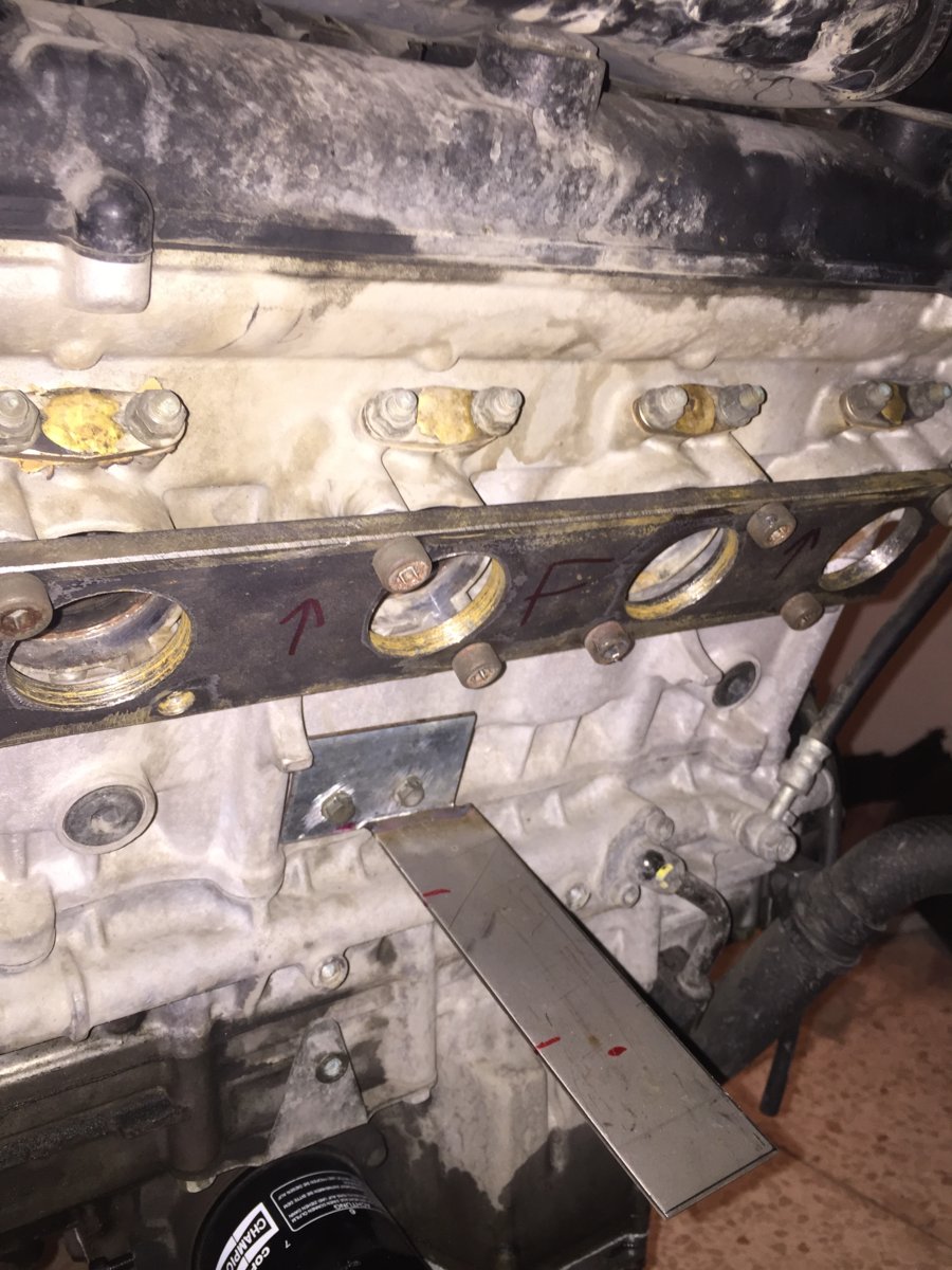

    Hello again after a year of research homework and parts selection i started the build of my stage 1 turbo.
    Parts to use is inline walbro gsl392(lower frame mount) custom fuel rail tabs begi fmu(new version) garrett gt2560 ballbearing turbo 60/64 a.r tial vband external wastegate 38mm tial q 50mm bov custom made headers to mount turbo as high as i can custom plenum and charge pipe.what you guys thing about the turbo used for daily driven bike an a big question about fuel controller is worth the extra money to sell my pc3usb and buy the pcv pti using fmu?

    When i make my headers i angle the 2 outer pipes at the head flange a bit so the bend rotates up and gives a better access to the lower outer mount bolts and a improved angle into the turbo

    IMG_0855.JPG A little update ready for welding tomorrow morning
