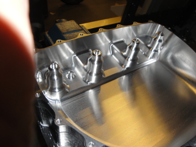

Inside of the top case finished. Towers are to hold the top mounted injectors. I think we can get it finished by Tuesday.
Great looking plenum, and excellent machine work.
For the most part its extremely similar in design to the billet plenum we designed over 5 years ago and still use today. Ours also have similar injector bosses or are available without them as well. Although we use silicone couplers to connect to the throttle bodies.
We also incorporated an intercooler in our design, and you can access all 4 spark plugs. As for you incorporating a laminova cooler and claiming it will be the most efficient cooling system on the market, I will challenge that, we have been doing this a long time now and already use the best and most efficient parts possible. The core we currently use is good for over 35 psi, at 65 lbs/min of airflow with only a 1% pressure drop across the core. This setup is what Bill Warner uses on his world record setting land speed bike, and what a lot of Prostreet racers use now as well. Now we are working on a billet plenum with a core that will support 1000hp,
Your plenum does look great, keep up the good work.
