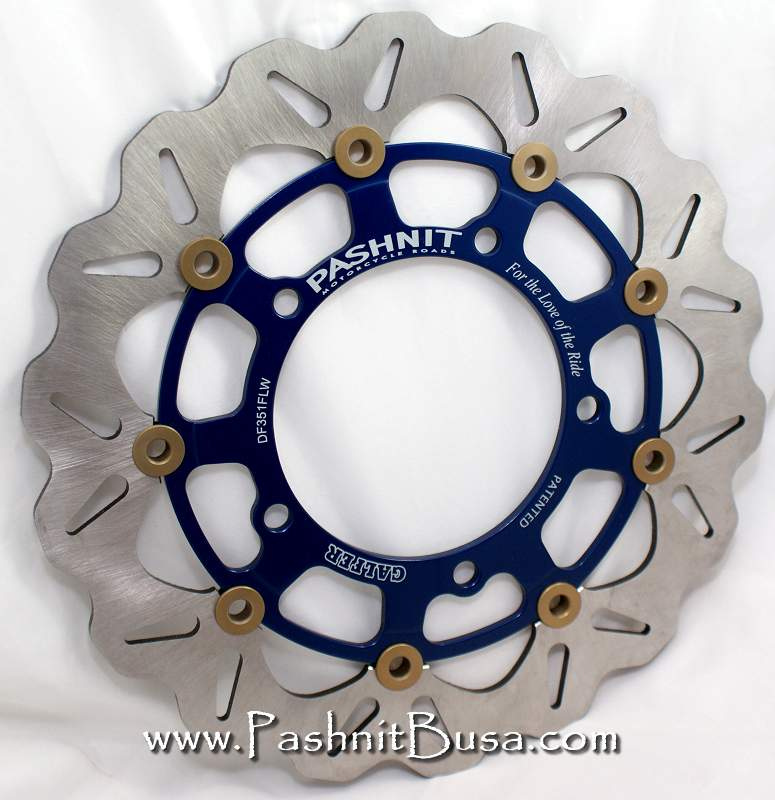

Is your suspension already set up for your weight and riding "style?" Still running the stock brakes? Got good riding gear?
1st post! Welcome to the org!!
You're asking advice on what mods to do, I'd also encourage you to improve your brakes if you're willing to lay down that kind of coin for some more horsepower.
Set the bike up for how you want to ride it: sport-touring, speed runs, horsepower, handling, comfort... pick one of those and go that direction. :bowdown:

Yes! Like Better pads,SS lines and sliders!
