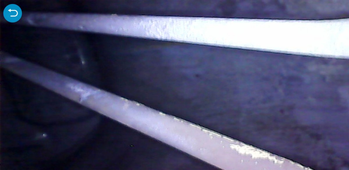

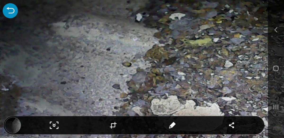

So checked tank internals and was in a sorry state.
Took before and after pictures using an endoscope.
Product has been used on three previous tanks and is superb ..and is environmentally safe!!!

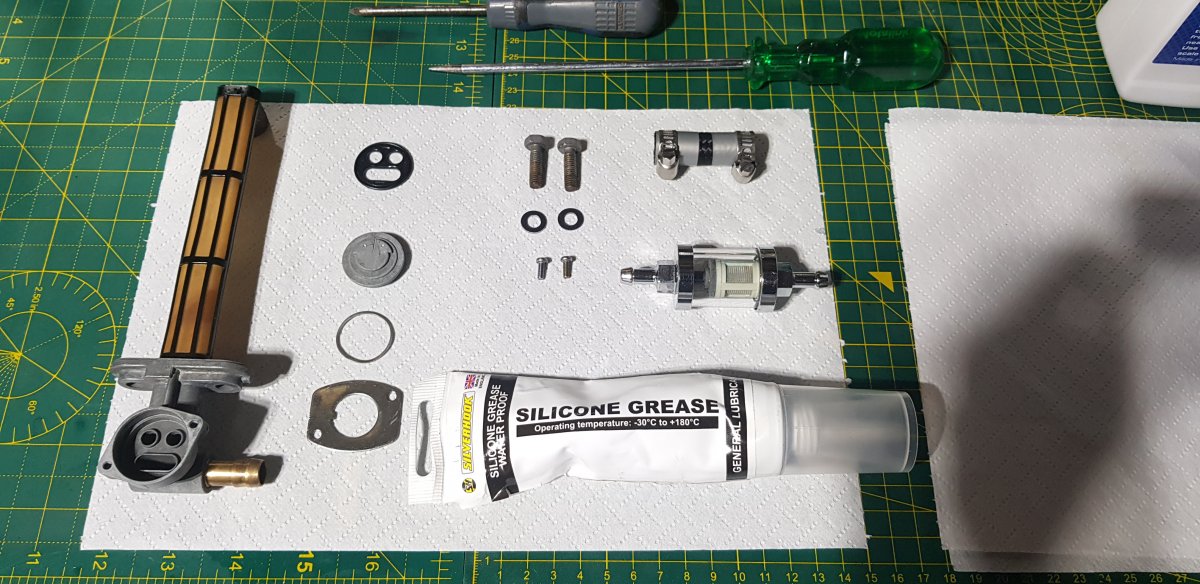

Nothing. Dried with hair dryer added some fuel swilled once. Drained and will half fill with fuel. No water or moisture present so should be good. Going to add an in line filter and make the tap able to shut off.

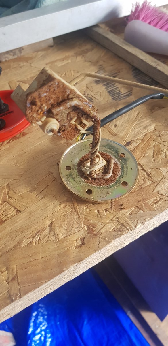

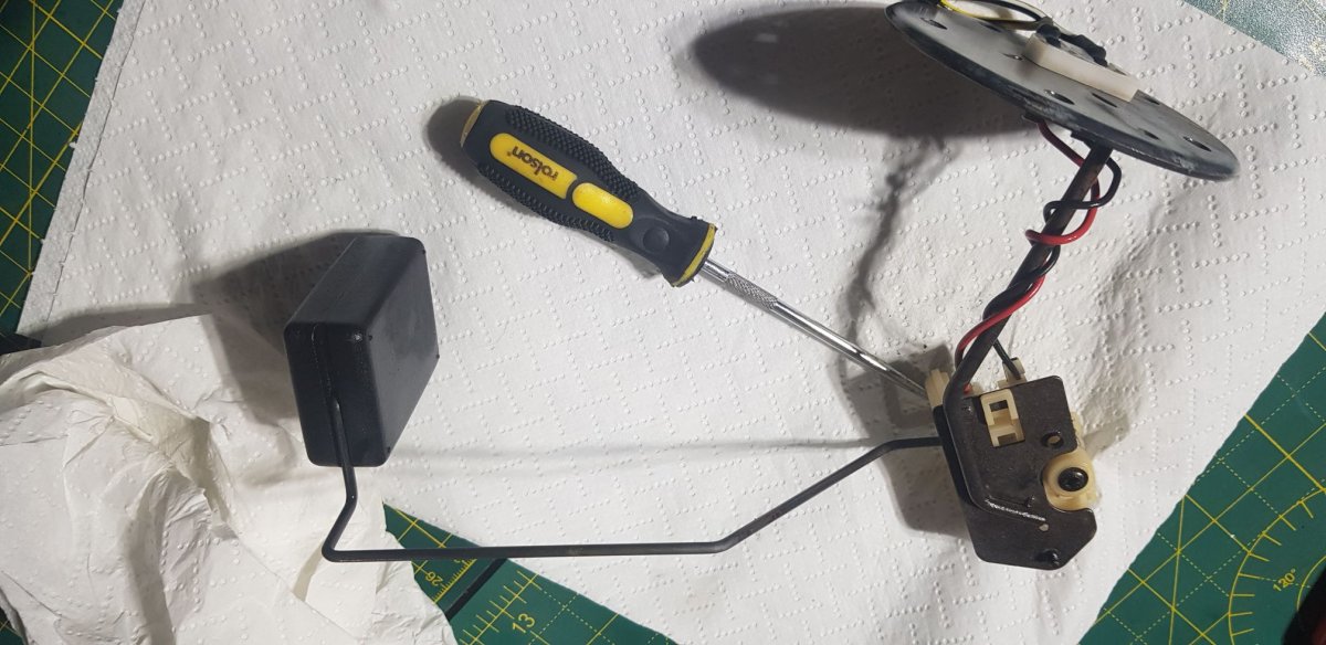

I have cleaned tank , petcock, adding in line filter short term . Fuel pump stripped and cleaned with new filters , orings and new electric motor. Injectors stripped cleaned in ultrasonic bath .So fingers crossed.....
