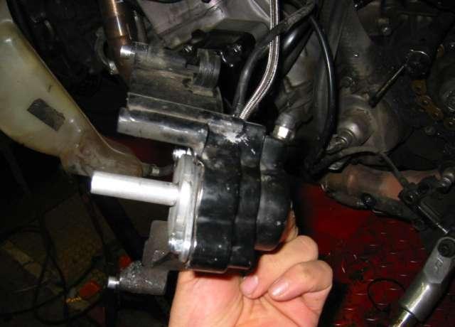

and if someone has the issue with the busa´s slave here my little hint:
buy the entire slave from the gen2 incl. the "cap" (#22) - it fits to the gen1
and
for all perfectionists:
get this silver alu piece
to protect also the rod and its damn seal in the crankcase/transmission wall from all mud.
highly recommended for both the gen1 and the gen2
available at "kojak´s" and his shop in germany and yes - he delivers also to the us ;)
