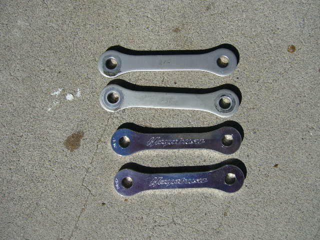

I lowered the front 3/4" and am going to raise the rear 1"... I also have 1.1 springs and the gold valve kit.. going the right way here??

Example, by raising the rear an inch, your bike will "turn in" better(feel lighter) than the stock geometry. But you gain this at the expense of stability. But the Busa is already more stable than GSXRs, so I feel that even though you lose some stability by raising the rear an inch, the Busa is still just as stable as a GSXR. I'm basically altering the Busa's geometry to be more like a GSXR's geometry.

If the front is lowered 3/4" after the 1.1 springs, you may find that raising the rear an inch may be too much, maybe not. You can try it and always go back to stock dogbones.

Since I mostly ride at trackdays, ground clearance to me is very important and always on my mind. In my case, my front was raised some by the .95 springs(I weigh 160lbs) and I run a 55 profile rear tire which probably equlizes the front's raising. And I raised the rear an additional inch with dogbones. So my whole bike is higher than stock but I raised the rear more than the front.

Charles, do you run a 180X55? I ordered a 190X55 by mistake a few tires ago, and I had it on at deals gap and I really liked it. I'm thinking about going back to a 55 and raising the rear up 1" to help the turn in.

I suppose I can skip the links and change them out at the gap after I get a day or two on them to see how it feels..

If you put the 3/4 risers on to get weight off your wrists, you'll be going right back to the same riding position when you raise the rear. When you raise the rear you will notice the chnage in riding position. I had to retrain myself to hold myself up with my back rather than my wrists. Light hands are always better.
Raising the rear doesn't make the bike faster, it just makes it easier to turn allowing you to be more precise with the line you want.
With the exception of suspension travel and ground clearance(which only matters if you ride fast enough), its all just preference. I love it raised up, makes the busa feel more like my 750.

Respectfully, I think this point should be made...when the bikes chassis is raised via the rear suspension, it effects the motorcycles handling irrespective/independent of rider position. That effect is because the angle relationship of the front forks with the tarmac is increased (made closer to vertical)therefore the steering is said to be quicker, toward the high performance end of the spectrum (the opposite being the extended rake of a chopper, for example). One performance exception to this, of course, would be extending the rake slightly to gain stability, like a top speed bike. When you raise the clipons (ie Heli Bars, etc.) for rider comfort, you do not change the steering head angle, you change your body's torso angle. Raydog
