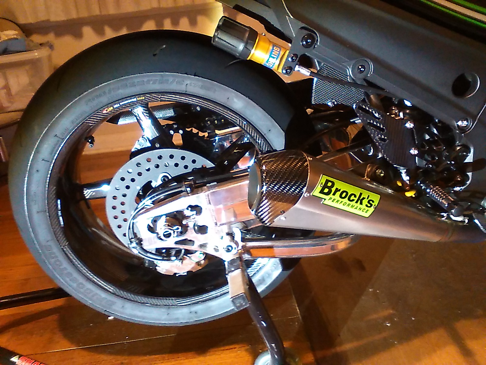

Mine look like this:
EBC XC Contour 5.5mm discs They are quite a bit lighter than stock.
Here is a description from EBC
Features:​
  • The steel used in the EBC rotor blades is a special stainless blend with higher friction effect than normal heat treated stainless steel found on stock discs
  • Boasts up to 10% improvement in friction effect improving brakes even further
  • Weight of the X and XC series is reduced by 5-10% by using a 6 only button drive system on a lightweight alloy centre hub, which once again grabs the lead over stock parts
  • The SD-System uses a square sided rivet with many advantages
  • The SD-System of square sided buttons means that the rotor can expand inwards and outwards unrestrained and that perfect rotor functionality is retained at any speed or load
  • This extends the lifetime of the rotor and prevents distortion failures
  • Keeps the rotor blades perfectly true and flat throughout their life cycle and technically the only reason for a rotor to need replacement will be impact damage or over a very extended number of miles possible rotor wear limits being exceeded
  • This means that a rotor equipped with the EBC Brakes SD-System could last 5-10 times as long as a conventional rotor built with circular buttons
  • The drive forces under braking are transmitted over a line contact on the square side of the button compared to the point contact of a circular button

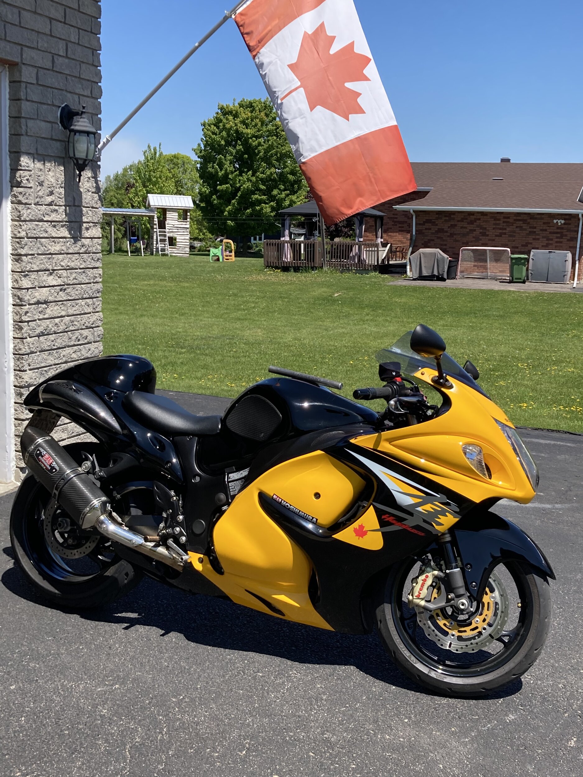

Bill, why has your bike got a steel rod sitting atop of your fuel tank??
