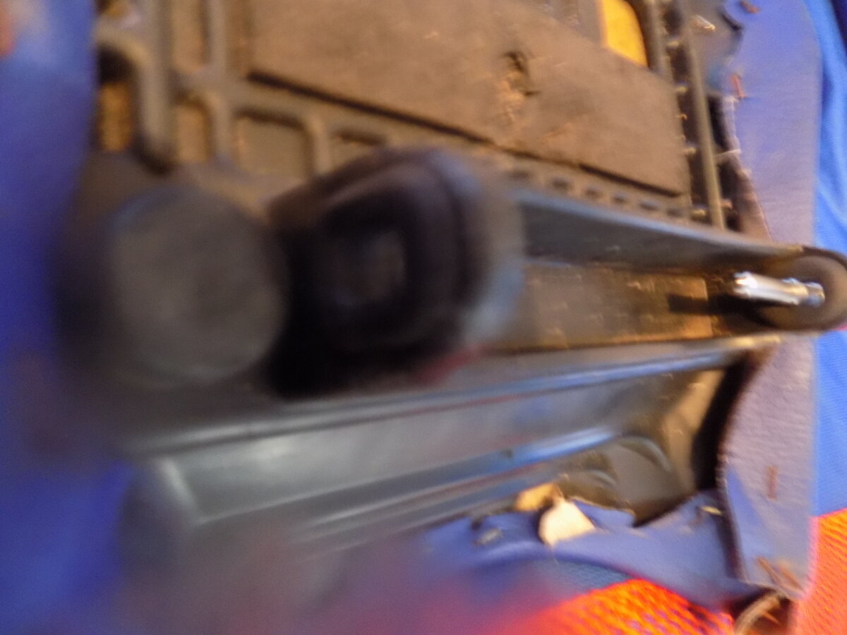

Twist clockwise. It just screws in to the frame and the unthreaded part holds the seat in place.
I believe Gen 1 seats could be made to fit the 2 but don't think it works the other way but not 100 percent sure. I do know Gen 1 the bolt sides thru the frame and screws onto the seat. On the Gen 2 the frame is threaded and the unthreaded part holds the seat in place. Now I'm sure there's a way but I would think a gen1 seat would be easier to install if it goes with the lines of the Gen 2 tail.

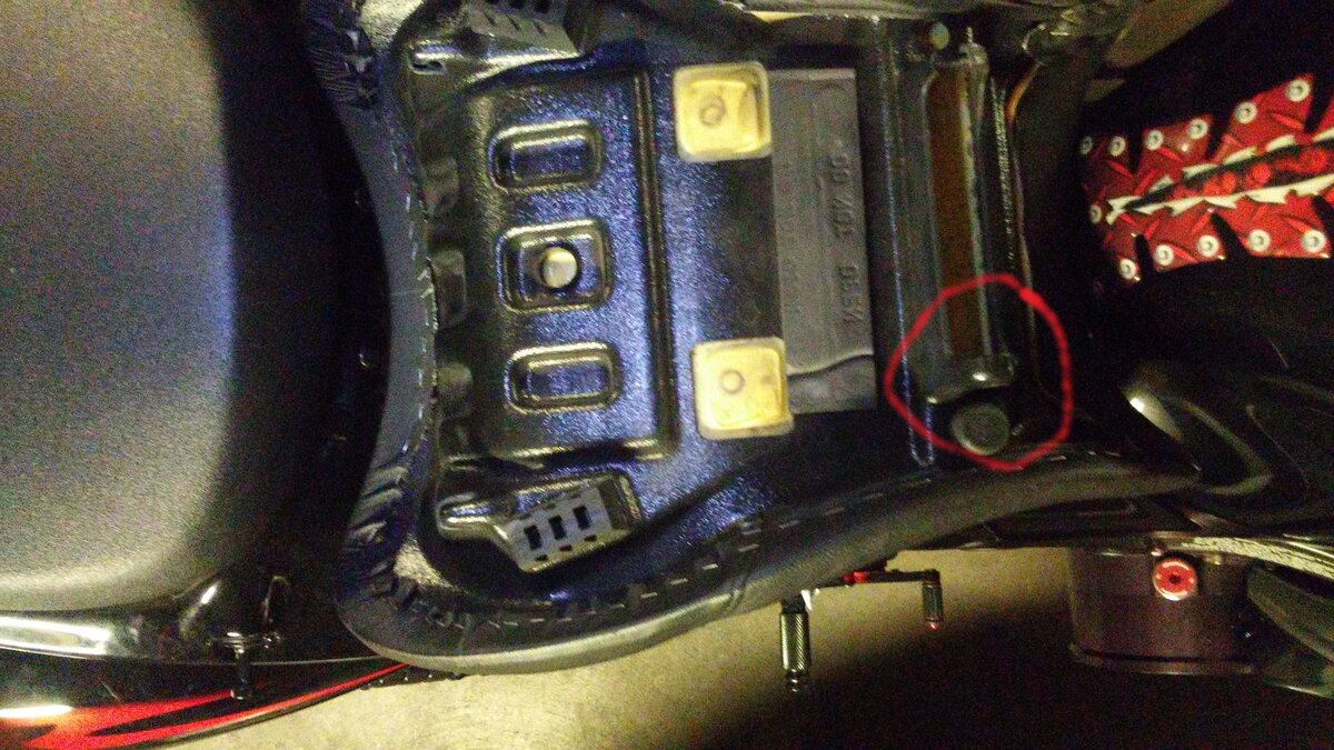

OK Thomas...Matt and Dopey are right. The Gen II seat will tuck into the places on the Gen II subframe with the hooks on the bottom of the seat.
As the boys mentioned there are no threads in holes in your Gen I frame.
The Gen I seat has threads on hardware attached to the seat bottom.
This hardware (see below) needs to be attached to the bottom of your Gen II seat. Thats option 1. Option 2 is to thread the existing holes in your Gen I frame and hope the holes line up. When you stick something like a thin screwdriver or bolt thru the frame hole,does it line up with the holes in the seat?
So those are our options Bro. Your choice. Thread the frame or attach the hardware in the area shown. If you want the hardware in the mail,let me know.
If you need a hand idea wise on how to line it up,just holla,I've got an' idea.
Rubb.

Thank so much everyone. I will try tomorrow when get to feeling better. Really appreciate all of you. Thomas
Rubb are yours threaded or push pin? These are the seat bolts I have so I have to have threads. I checked and my seat holes will line up with my seat , so if I knew what size the threads are I could try to put threads in the frame. Rubb if I get some like you have will they give me +100 h/p? lol... Thanks all

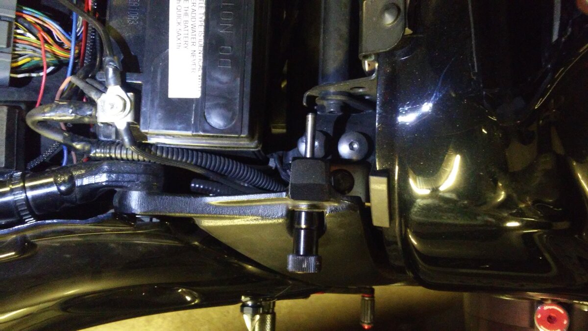

Mine are threaded (Gen II) Your frame hole are not.
Somebody,if I don't get to it first,I'm sure will measure a bolt and tell you what tap you need.
If you want to save yourself the hassle lets go with @Mathewrussell52 idea and order them from Amazon. They look cool and the Busa seat comes off a lot at times...plus they look cool, come in blue to match yer ride. Maybe he (Matt) can tell us what length to order.

Member @Mathewrussell52 said he just drilled his threads out.Guess that allowed a larger diameter pin.:thumbsup:

Ones I bought were 5/16. Believe that’s thread size it’s not a perfect fix. I bought them to long believe 3.5in they will back out a little the perfect one would be 2 inches and the little balls that pop out would be one inch in. Haven’t looked that hard it works for me I did it so I can pull seat and pop tank quickly.
