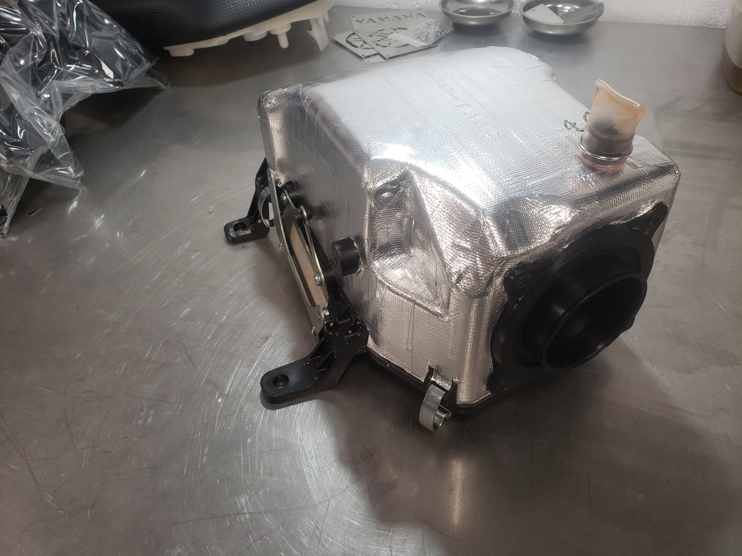

@greg3852 wrapped alot on his gen1

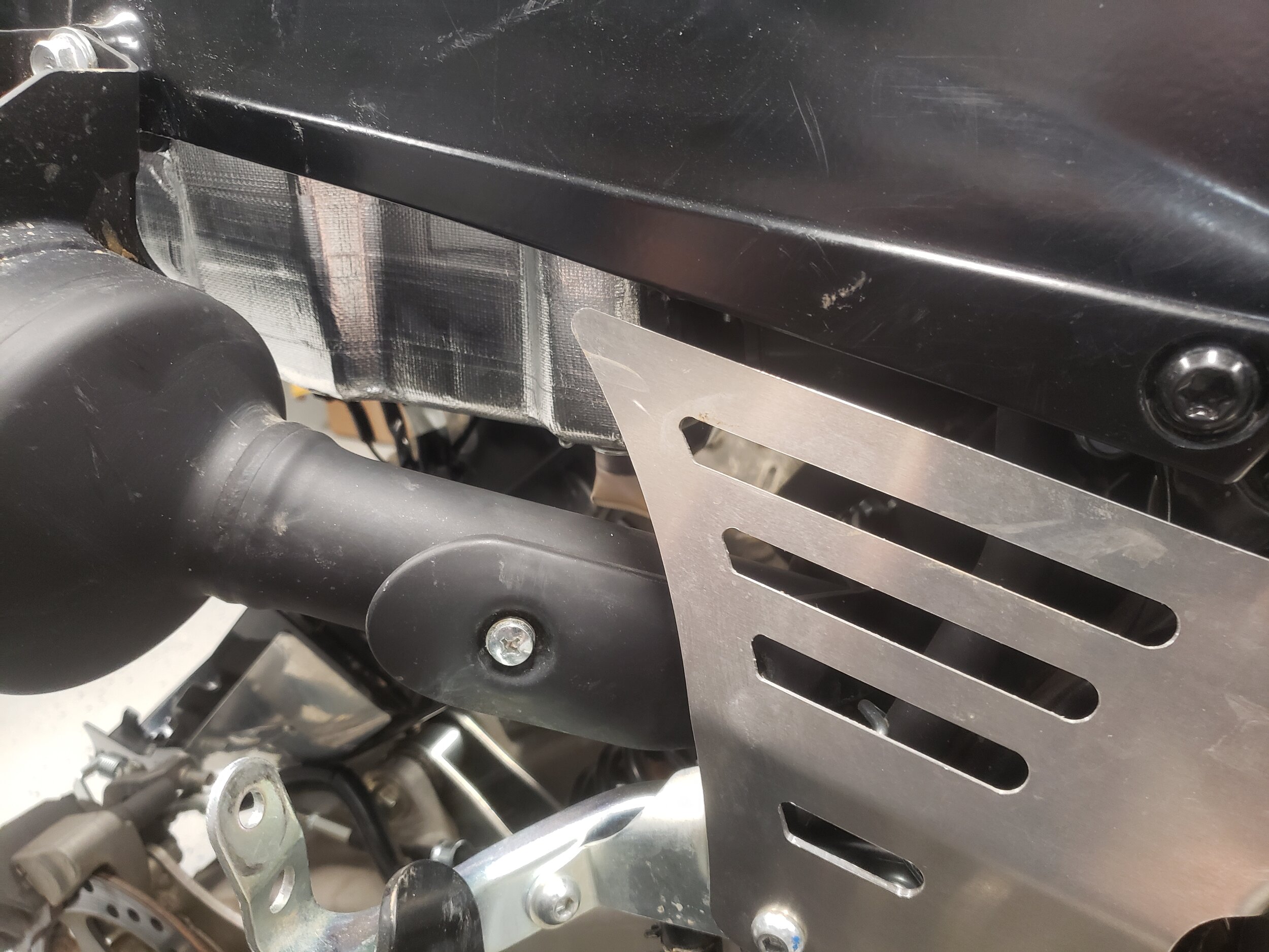

I did this on a Raptor 700 that I had, as the exhaust passes within inches of one side of it.
Does it make a noticeable difference?
No, but the less heat the air picks up the better.
Gains are likely miniscule, but in theory, they have to be there as a result.
It was kind of a 'why not' mod for me, I had a little extra time and the material so...

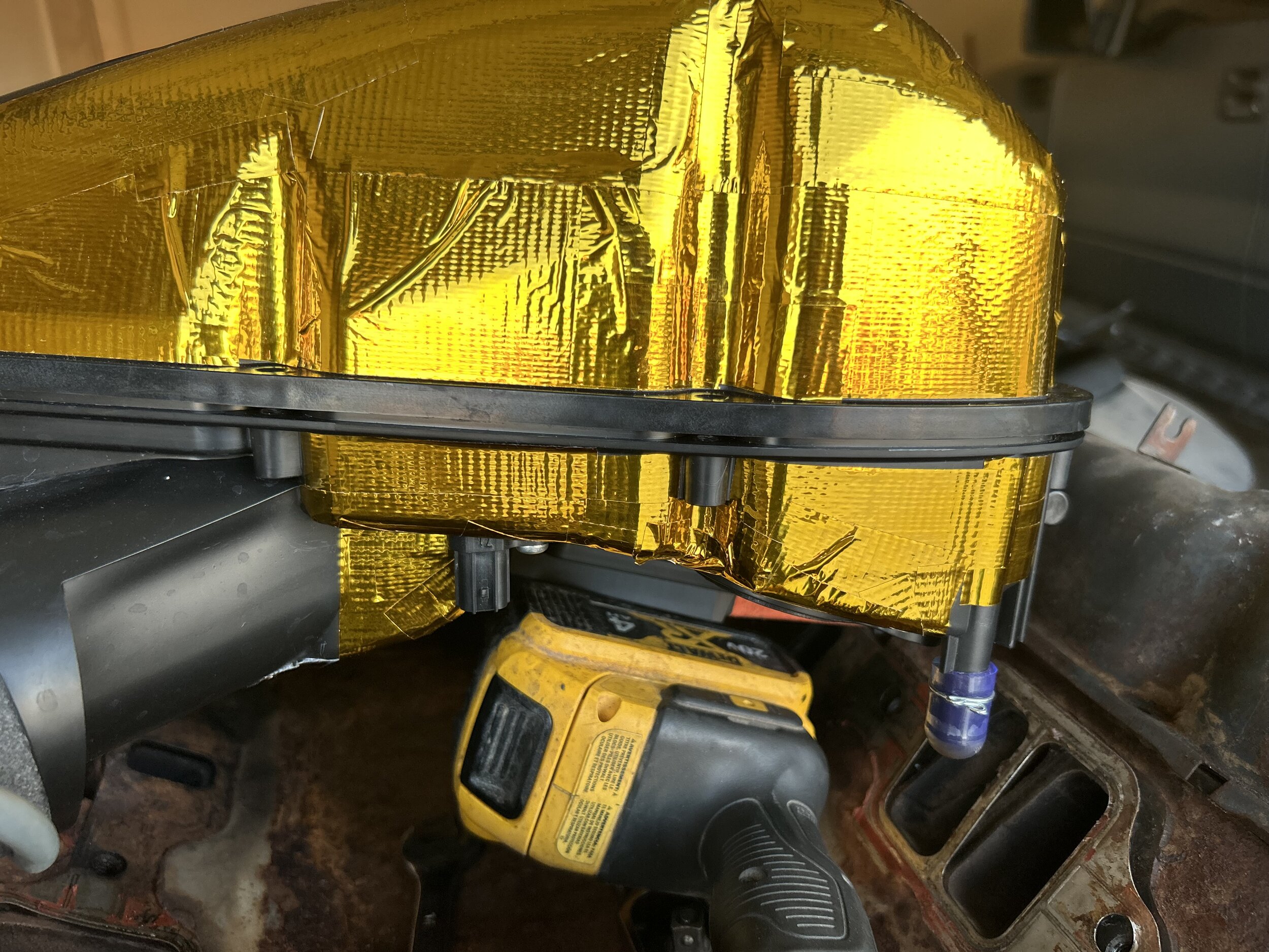

Speak for yourself. I ride mine hard all the time and for long distances. (Don’t even say it). It’s called DEI gold tape. It does work and keeps the heat out of parts. I wrap my starter in it, and my plenum. I want it as cold as possible.
Btw they use it on the Mclaren F1 super car. It does work.
