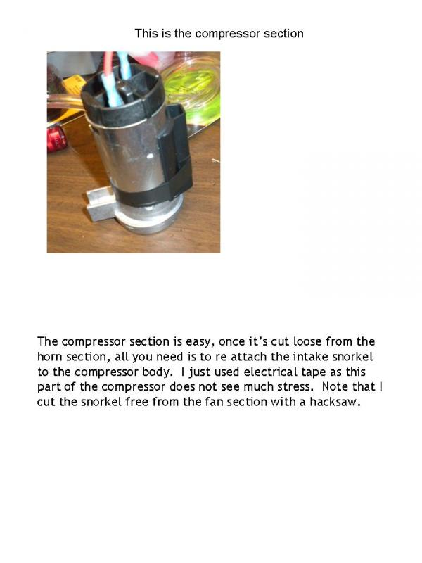

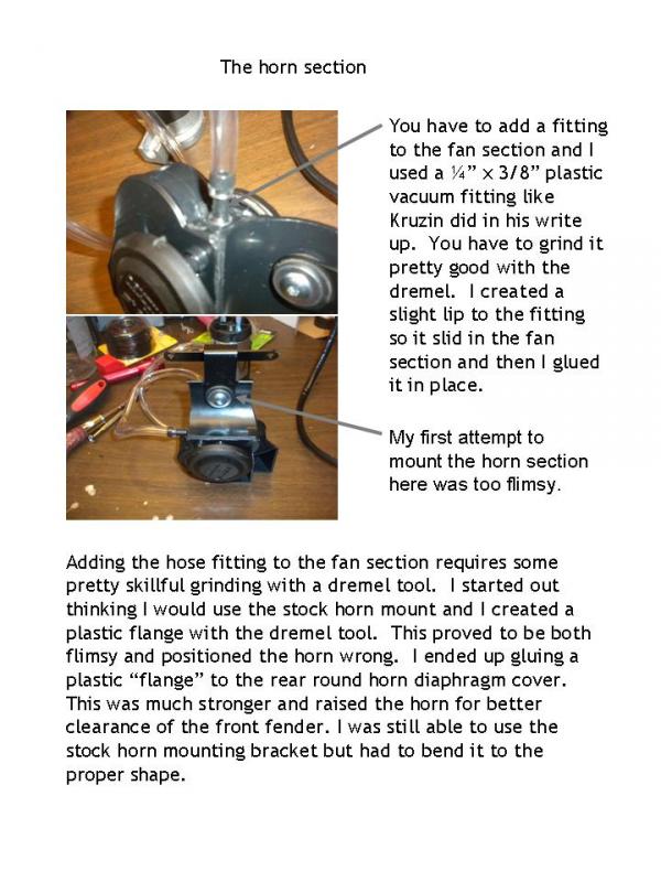

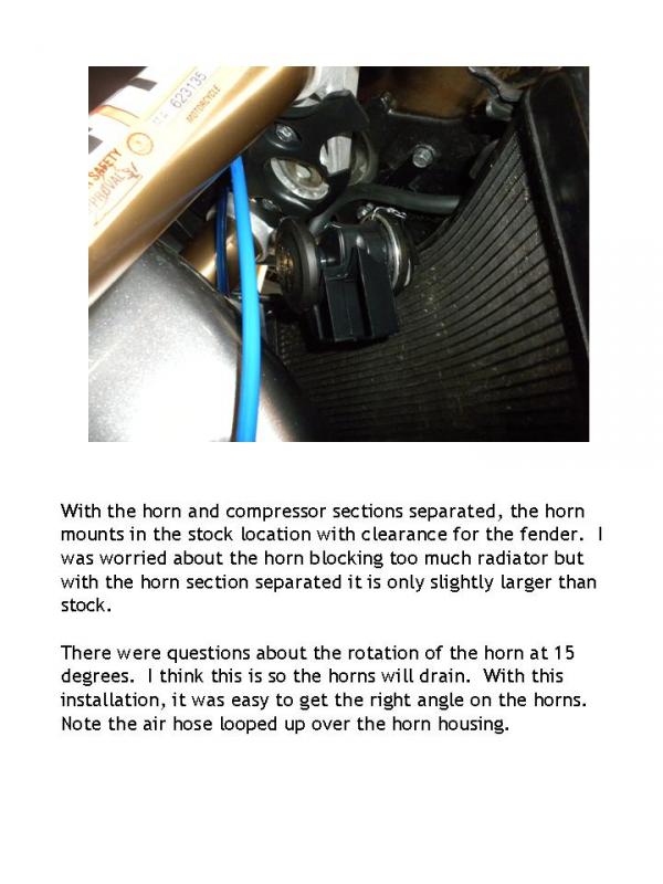

After reading Kruzin's post where he seperated the sections of a Stebel air horn and mounted the compressor seperately, I was inspired to give that install a try. The end result is pretty clean, so thanks Kruzin for a great idea.
