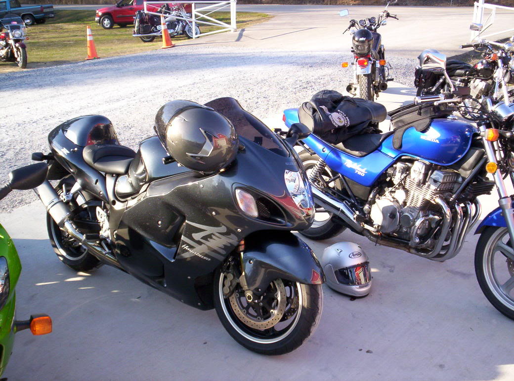

Ok, now I'm going to add my .02 worth. Save yourself some money and go to your local nut and bolt distributor with your stock triple tree bolts in hand so they can give you a longer bolt to accomodate the length you want with the same tensile strength or stronger which is stamped on the stock bolts. While you're there  get a couple of washers to. The goal is to stack together enough washers to accomodate the size you want for each bolt.
Before you install anything glue your stacked washers together  and paint to match your bike. Just make sure to keep the lenght of you stacked washers below 1.25" (max height).
I've personally this done mod to both of my Busa with no ill effects.  Its the same concept just cheaper and just as strong or stronger.
I GOT MO TIME THAN MONEY !!!
1.25" drop in front.

Those will work just fine. I have exactly the same type but I lowered 1.25".
True, not as cosmetically pleasing as reaper risers but more cost effective.
