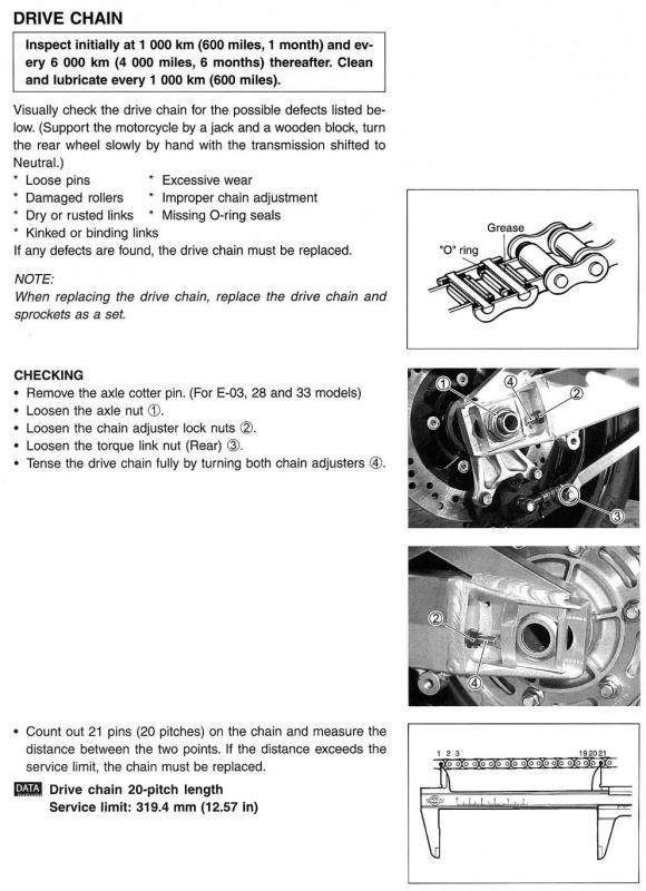

Here.

Who in the world has calipers >12"?? Got to add another tool to my wishlist, lol. Yeah, that's a ton of miles on a chain/sprocket set. Pat yourself on the back for taking good care of it and go get another set to use and use and use!
