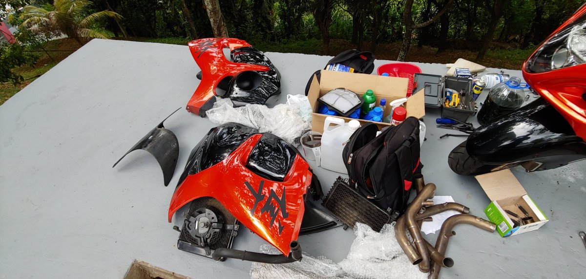

Man, I did this operation 2 times in my 09.
If you are super carefull and confident on what you do, and has small hands and proper tool, it's possible to perform the operation without removing the oil and the cooling radiator. I'm not, and to avoid damages, I removed both. oil change will not be necessary, but cooling fluid will.
Remove side fairings (the job can be done in the side kick stand) remove both stock slipons, unplug and remove O2 sensor from the stock pipe. Remove both cooling and oil radiators. Cooling fluid will split, take care of it not to mess up your working environment.
There is a bolt under the catalitic area, in the midle of it (You will be able to see it by laying down on the ground), then remove the 8 bolts in the engine head.
Look at pictures of your new exhaust in order to assembly it correctly, then rebolt everything into the bike, reinstall radiators, refill cooling system, remove the air and reinstall fairing. You'll need about 4 hours for 1 man job. Unfortunately I only have a few pictures of the job. Good luck.

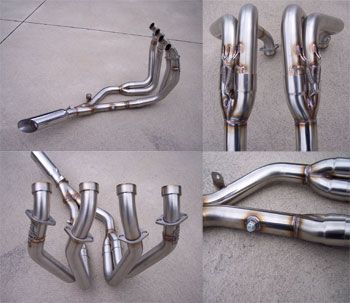

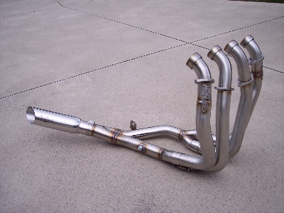

Ok seriously. I get the voodoo tips are over priced and obnoxiously loud. What is wrong with their header? It's stainless, has good welds, fits well, and is a stepped 4-2-1 design. My bike came with one and it doesn't seem that bad. Maybe a premier brand would make a couple more horsepower but I can't see it being much. It looks just like the yoshimura header. Is there something I'm missing here? If I put one on right now I'd choose the Hindle system and not one of your 3 acceptable brands anyhow.
