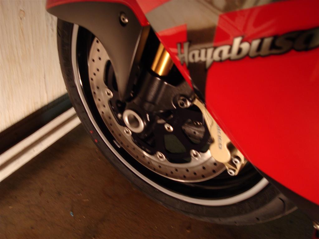

and a certain ebay guy came through and scored me a new "take off" pair of front rotors after my local guy tried to dress out my 20,000 mile pair and really "screwed the pooch" in the attempt.  Talk about "WAY" less than the stealership.......new pads courtesy of Vman (Kevin).....

After all was said and done, I started measuring things and found out my forks had shifted positions...
, as in, my left fork was still seated up against the handlebar / tree cover, but the right had shifted "DOWN" about a .5cm, or around 3/8". I had to get the forks realigned before the test drive, but now everything measures out within 1mm. Watchout wheelie kings....they shift when you bounce the front end under the stock torques specs. Either that, or whomever built this at the dealer never bothered to check them....I'm thinkin' it was the wheelie practice a while back. ...
